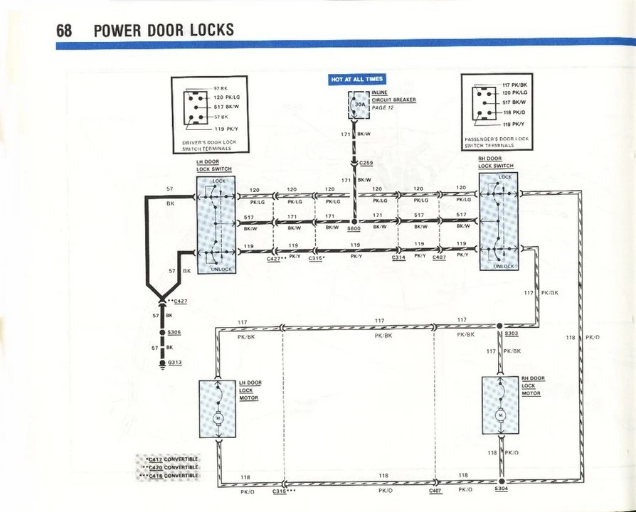

Unfortunately I haven't seen a wiring diagram for the power door locks. If I had one, I would post it for you.
Thanks to the diagram, you can see how the switches are working. Check for 12 volts across the inoperative motor when you actuate the switches. The switches reverse polarity across the motor so that one way it locks and the other way it unlocks. For this reason, test the motor in both lock and unlock modes.
If you are feeling energetic, swap the lock switches around and see if the problem follows the switch.
