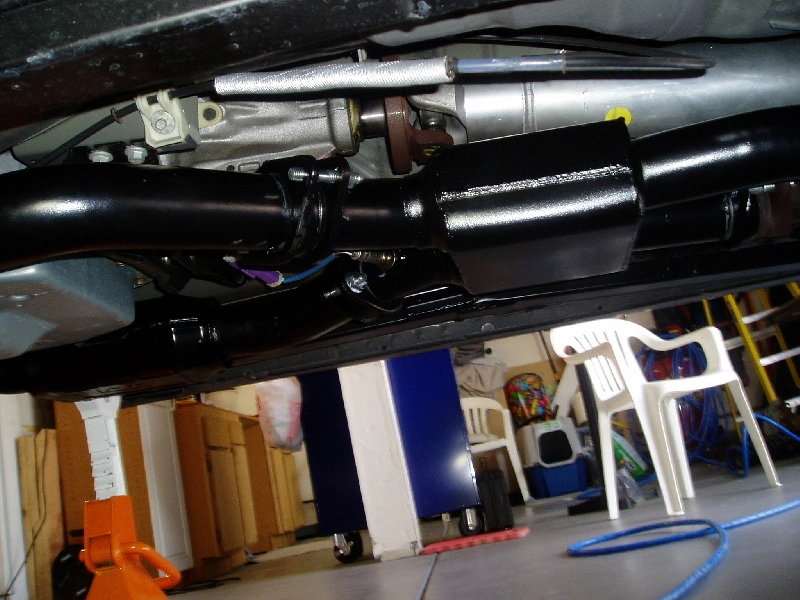

R Rocketman New Member Apr 20, 2004 730 0 0 SoCal Jun 13, 2005 #5 Jun 13, 2005 #5 FRPP Aluminum drive Shaft installed on an 03 automatic. You will need to change the yoke over from a manual to the automatic yoke. Ford only sells the DS with a manual yoke on it. The yoke for an automatic costs $300 by itself. Attachments Pro-Chamber%20Installed.webp 191.1 KB · Views: 116
