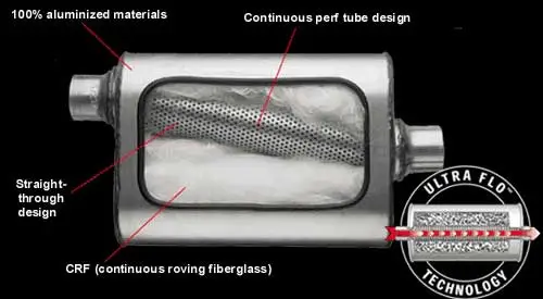

I went with these and I love them. No drone, great sound and quiet cruising. Don't get me wrong, you still know it's V8; they are quiet enough when you need them to be, but will still get plenty loud under WOT.
Borrowed from Jeg's site.
http://www.jegs.com/p/Dynomax/Dynomax-Ultra-Flo-SS-Mufflers/744882/10002/-1
