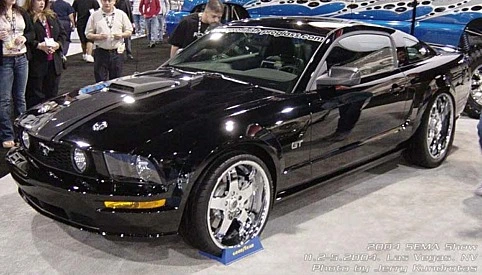

How low do you think this Mustang GT is dropped? Anyone want to guess on the size rims?

I know that H & R springs has a kit for the 2005 Mustang ready to go. Im told they make two diffrent kits. I think one is a 1 inch drop and the other is a 1 3/4 inch drop. Im pretty sure Eibach also has a kit ready to go. Depending on the kind of wheel and tire combo that you will want, you can put 19, 20 or 22 inch wheels on a 05 Mustang. The white and orange boy racer at SEMA had 22 inch wheels and tires. The Street Scene orange mustang had 20's- this one used 20x8 inch front wheels and 20x10 inch rear wheels. Tire sizes were 255x35x20 fronts and 285x30x20 rears.
