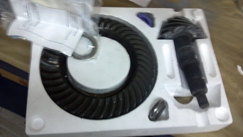

I've had these 4:10 gears on my work bench and wanted to put them in my 07 gt - but I would rather have the professionals do the actual 'gear' part -
I found a great place - the guy who told me about it said to just simply drop the rear end out :eek: and 'pick up truck' it over there - (they do like (4) four a day ) been in Biz for 30 yrs - if you get it there in the morning - it's ready the nxt day - for $125.00 - with me buying the parts - which is fine (I have them all) - the car only has 25k on it -
I've always wanted to paint the rear axle (it's the only rusty part on the whole car ) - if I disconnect the emg brake and the brake lines / d/shaft / pan bar / drop the springs - and the four bolts .....will it just drop out?
- I tried researching it - but I was wondering if anyone has performed this already? :shrug: is there anything with the angle / symetery to look out for? ....I don't want to mess this up -

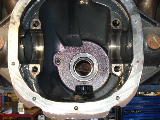

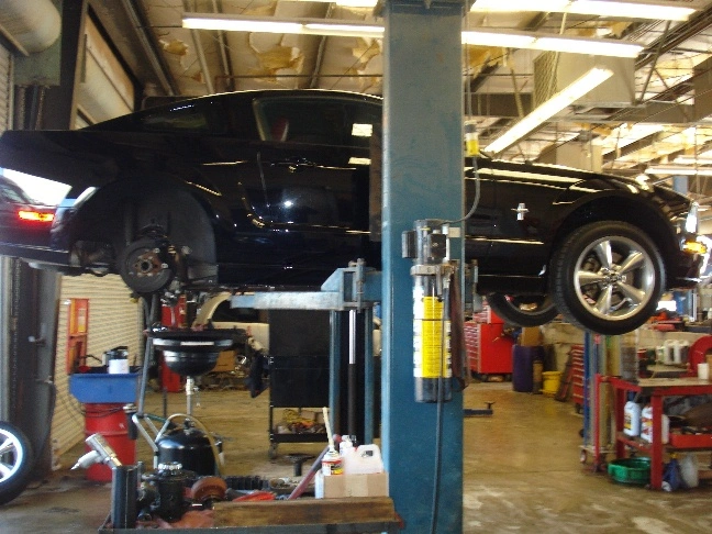

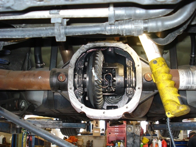

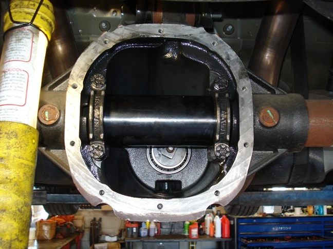

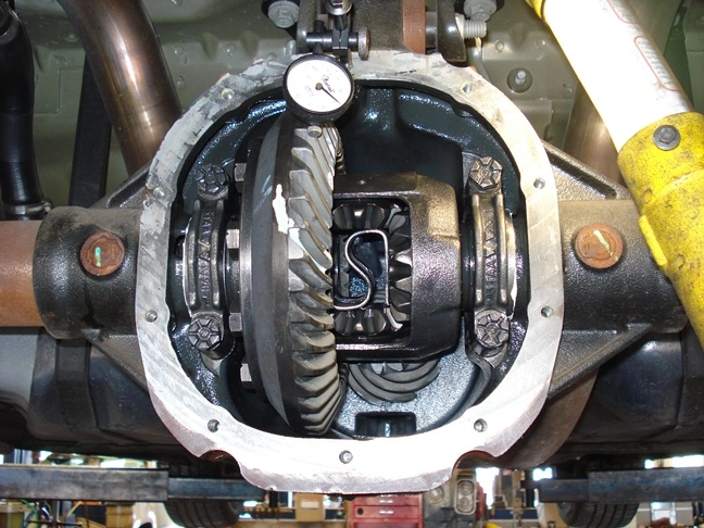

Photo's from this past Saturday - My buddy got me into his Ford dealership bay - Ford techs have all the special tools needed /which is awesome - still took 6 hrs -:confused:
New 'race' installed -

the FoMoCo special tools
8/9 thousandths backlash - slipped right in the 1st time :eek: - Buy the authentic Ford racing gear for your car - it works well with the existing components-

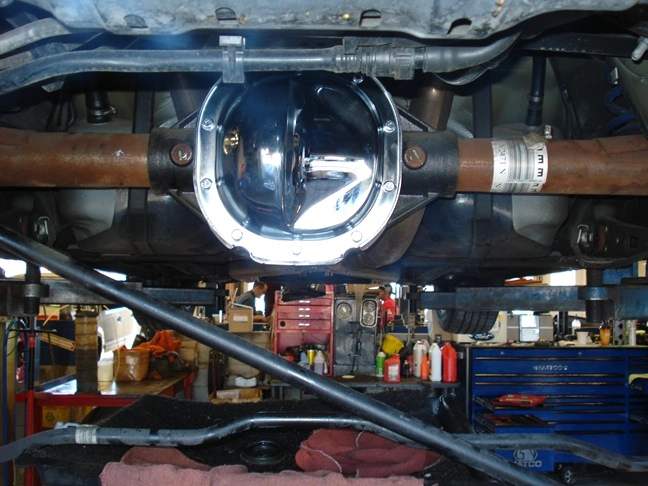

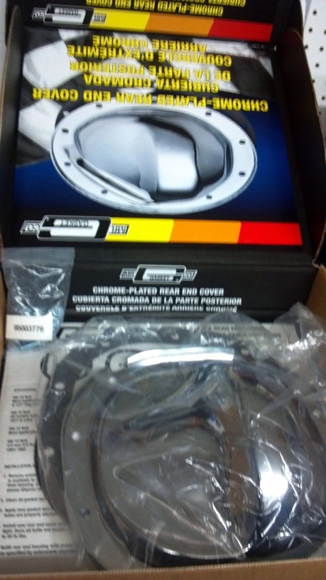

Chrome cover

Thanks !!....a little odd getting used to - but I can tell it's a great improvement - when I took the tires off - my tech friend was making 'fun' of me - the right rear tire showed excessive 'wear' - and he's like "I thought you babied this thing?" - and I'm like - yeah I DO! - ...........off to get new tires for the back - probably getting Michelin's - the car only has 25k on it - but it has been around for 5 yrs - note - Ford Credit sent my title the other day and a letter saying 'paid' in full .....:D!!!!! ....but of course the Ghetto ford dealership that I bought it new from misspelled my last name on it - wtf?
If you plan on hammering it from time to time may I recommend a bearing cap support type diff cover. They do help the diff live longer. Some people call them a "girdle" type cover. In any case, glad you got the gears now get the speedo calibrated after you put on your new tires.
I know what your saying - but those are mucho bucks - I hardly drive this car - it seems find - no drag strip for me w/this thing - the speedo needed no adjustment - the tires were a direct factory size replacement - I changed the gear ratio with the tuner -
