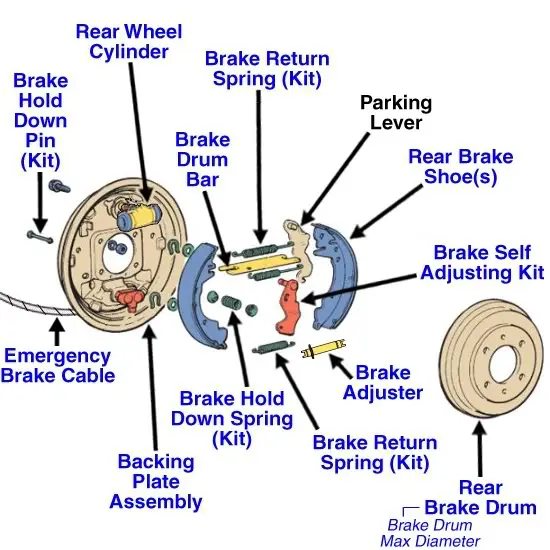

The "Brake Adjuster" listed above can be lengthened and shortened by turning it. This device has "teeth" on it. When you are backing the car up and you hit the brake, the Brake Self Adjusting Kit arm, turns the Brake Adjuster. Of course, you can set and adjust this part manually during installation. You can also manipulate with a flat tip screwdriver through a slot in the Backing Plate Assy after installation.

If you got the rear brake drums really hot when bedding in or adjusting the brakes and then parked the car with the emergency brake set, it may cause an out of round condition in cheap drums.
Drum brake assembly
I recommend that you print this post and tape the first drawing up in front of you when you reassemble the brakes. It is very easy to do it wrong and without the drawing in front of you.
The springs and shoes are position dependent, so look closely at the drawing when you put it back together. Make careful note of the FORWARD ARROW that points you towards the front of the car. When you install the brake shoes, remember: short shoe goes towards the front of the car.
Here's two pages out of the factory shop manual...
