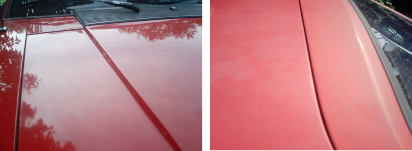

So I take some polish and clean it up real nice, and put a coat of wax, and the Indian Outlaw shines up real nice. Like the hood shot on the left. However in a couple months, it looks like the roof shot on the right. I'm getting to old to Maguiere's 3 step thing thing every few months, although lately, I just do it before a show.
So what's the deal?

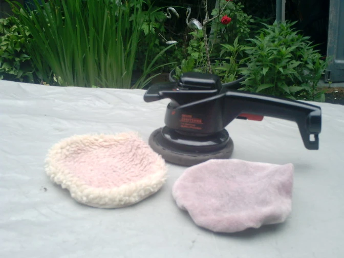

Hope this clears up some stuff... I also have a 7 in Craftsman buffer. I use mostly terry cloth bonnets for the cleaner, and aply wax by hand, and buff it off with a wool bonnet.

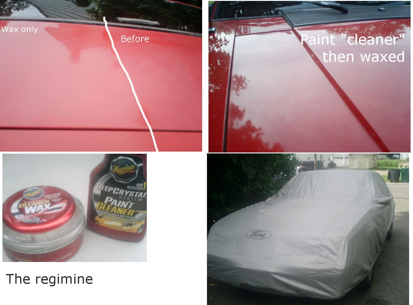

I should have posted this with the above, but I forgot to shoot it. We have a storm rolling in, and I left the sunroof open on the Stealth Fighter. So when I went out to put it down, I clicked this real quick.
You probably don’t want to hear this but it’s time for a repaint. The paint is dead from oxidation. You can wax until the cows come home but it will keep coming back. If I were you I’d stop buffing on it because by now the paint is probably super thin and it will be easy to buff through it.
I have owned my car for five years, and I have probably waxed my car one hundred times. Sometimes I would wax it three times in row. I know you don't want to hear that, but my car is in great shape so I really can't lose. Better than a paint job price wise. It took thirty waxes just to get it so paint didn't come off on a rag.

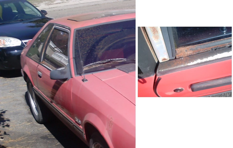

Well, a re-paint is the only way to fix this mess. It got sprayed with some kind of hot shavings from a grinder of cut off wheel. The stuff was so hot, it embedded in the glass and paint. The shop denies even having a tool that could do that! :o Wait, you're a body shop and you don't have a cutter or grinder? FU Troy! But as money is tight for me, I was hoping for some mirical polish that could buy me some time.
