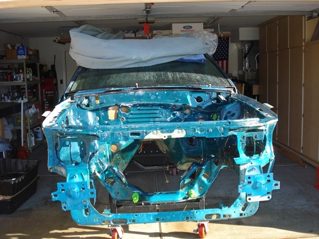

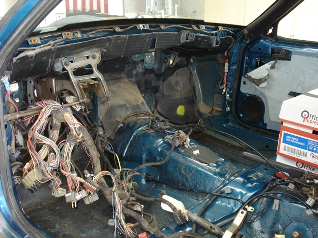

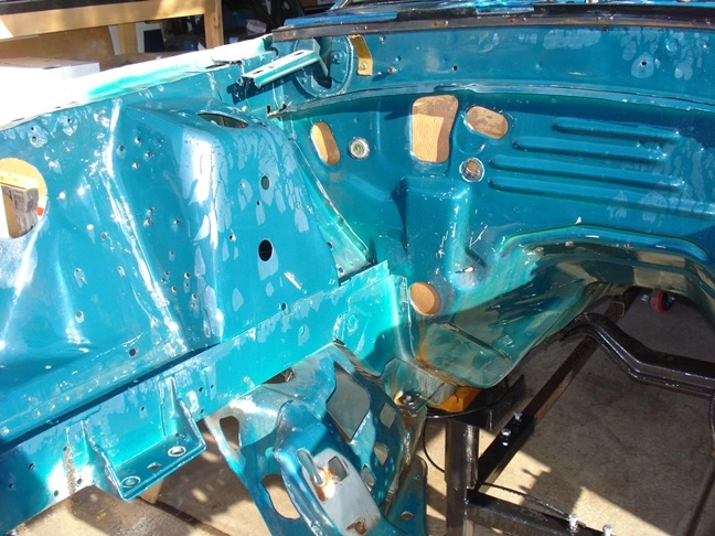

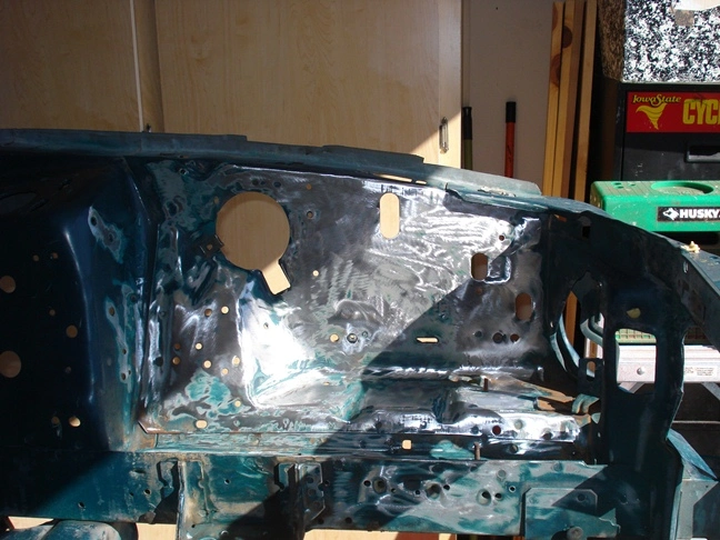

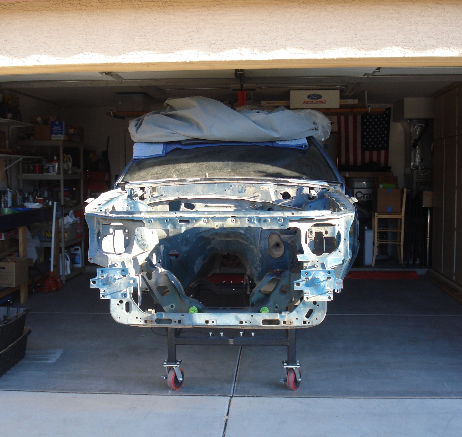

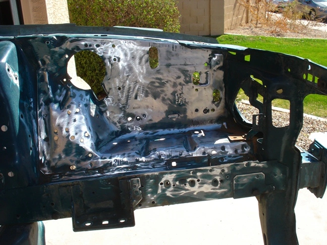

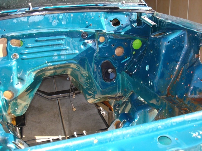

Anyone have an opinion on either using Dupont Vari-primer or Epoxy primer on bare metal? - I hear Vari is an excellent corrossion inhibitor - but can be a little more costly - I'm at the point in my project where I'll be spraying it soon - I have a steel contractor who is going to CNC all of the metal plates for infill on the larger holes - some pic's of the progress.....:confused:
I first degreased everything - which isn't as easy as it looks - alot of sharp edges - which create alot of little cuts that burn along with the skin on my hands and arms from the chemicals .

I'm not familiar with the vari-primer. What is it's base? Urethane? Epoxy will be a big pain to sand. Are you planning to apply filler on top of the primer and then prime everything again after sanding? If so, epoxy may not be such a big deal to seal everything.
Hey Scott - not sure - my old boss at the bodyshop swears by it - that doesn't make it a complete truth - he said to lay this down before any other primers or sealers / light coat of Vari-prime on all 'bare metal' - standard procedure at his shop - and his shop is one of the best - I'm asking him if it's 'before' you apply any filler or "after" - he said that after it's applied to the metal - you can build up all kinds of primer coats and sand after that "till my little hearts content"..... his condescending words - I was a wet sanding maniac back in the day -

I see its an etching primer. Yea, you don't want to put etching primer on top of filler if you can help it. Etch primer is a great sealer for bare metal though. You may have to strip the entire bay down to bare metal if you plan to spray it with etch primer. Not entirely sure about that though.
Yeah - I'll have to talk to my old boss - I have a ways to go - b/c I plan to just 3M red scuff the firewall (no filler or metal in-fills there ) plus the underside and topside of the K member - but the rest ....see I thought I could just sand it all down to bare metal - weld the metal in fills in / sand that smooth ....apply the filler / - then start hitting it with a self etching primer. Maybe I'm off - let me see what the old man says.
It all seems like preference. Some say don't apply filler over etch, some say don't apply etch over filler. Different strokes for different folks. I think the manufacturer of the product has a lot to do with it as well. The more you research about it, the more you'll get confused. I only used etch in the engine bay where I had large bare metal spots. I urethane primed my engine bay, which does not like bare metal, so that was why I needed the etch in spots.

Thanks Scott - yea I guess I'll keep looking around / research and come to some conclusion - thanks for the link - I was always use to the fact that filler loves bare metal (although that was 20 yrs ago) - so ur right confusion confusion .......I have some time - hopefully I will have it prepped out this weekend.
