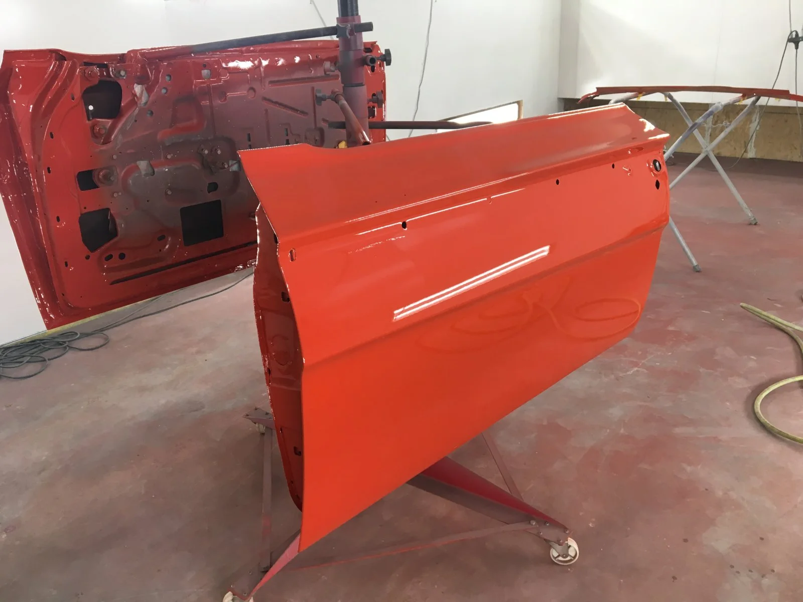

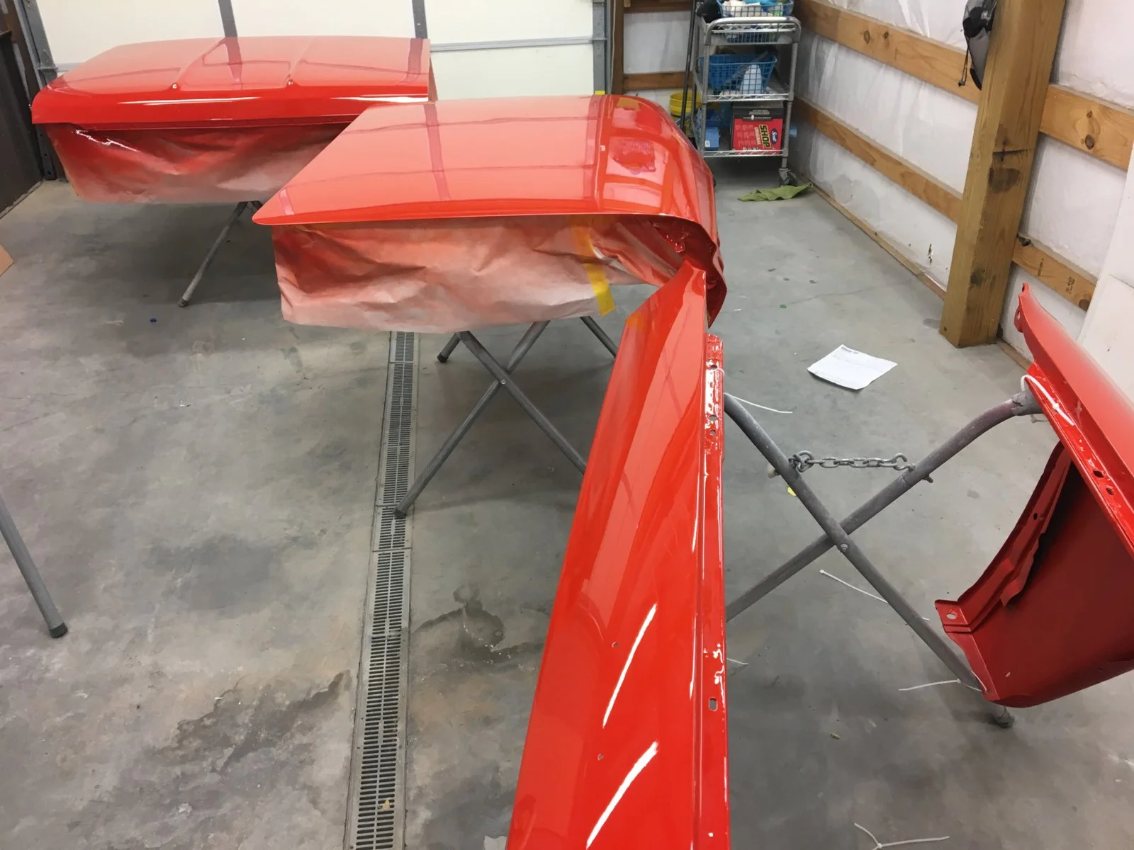

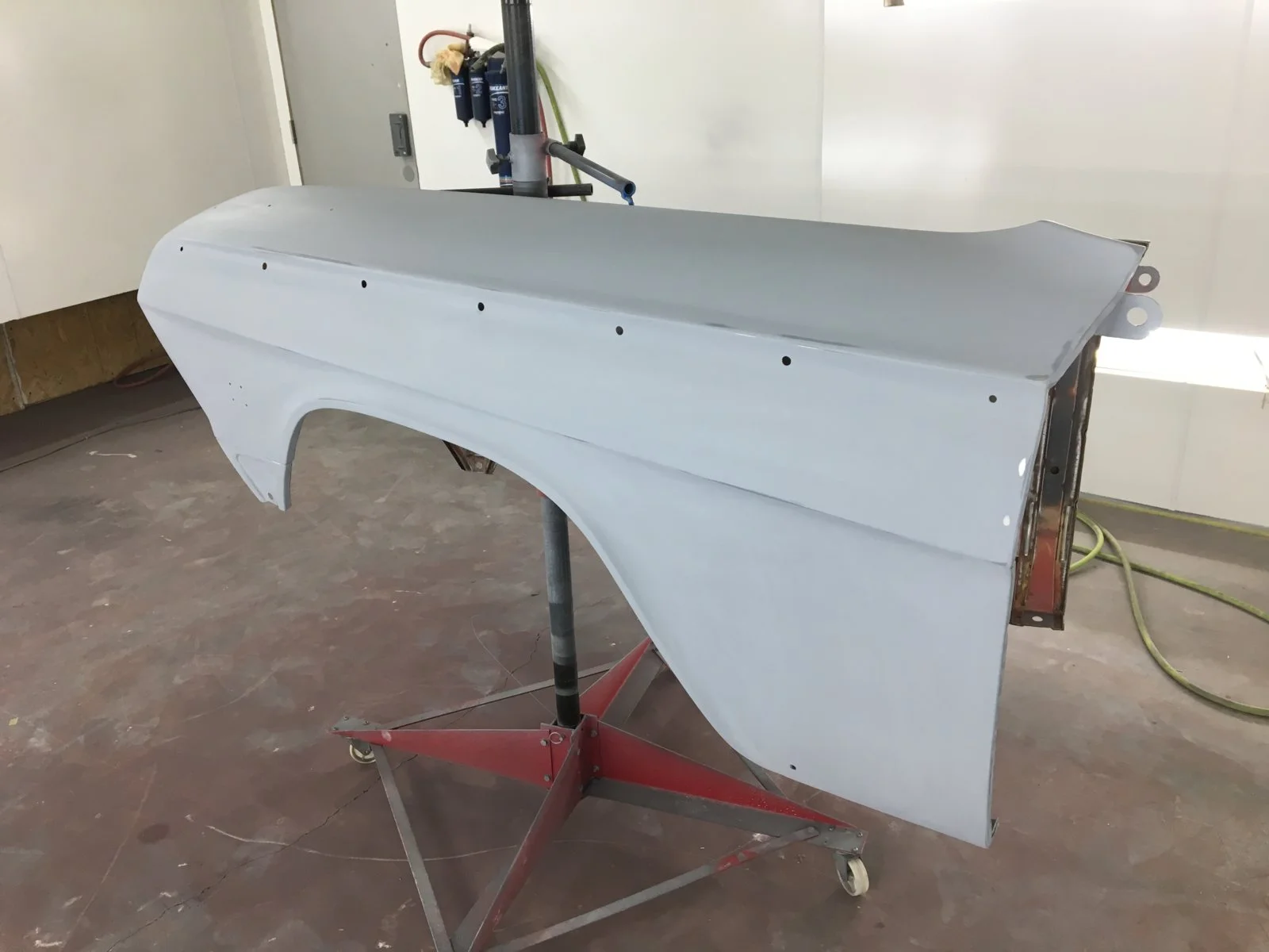

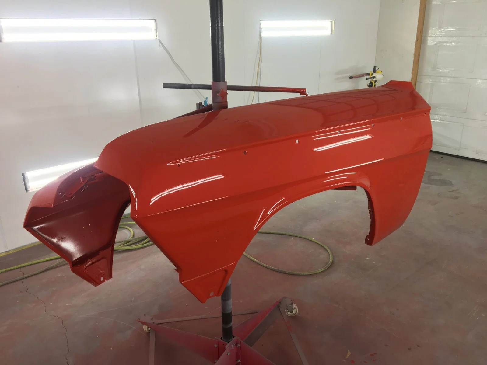

Ok, got the fenders shot. I’m pooped, I’m going home.
Tomorrow I’ll shoot the doors and prep the body so I can paint it Monday morning early.

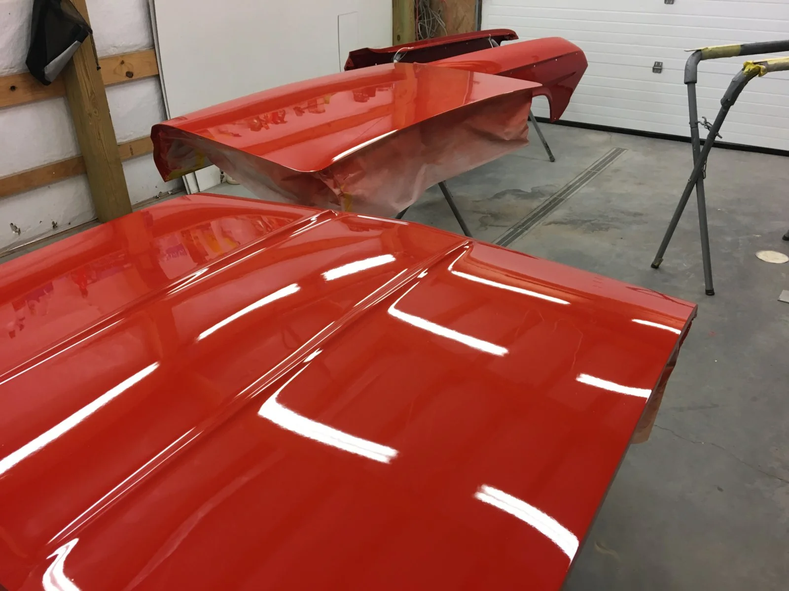

I’ve got the doors all prepped and the cowel panel, I’m painting them right now. I’ll get a picture after they’re shot.

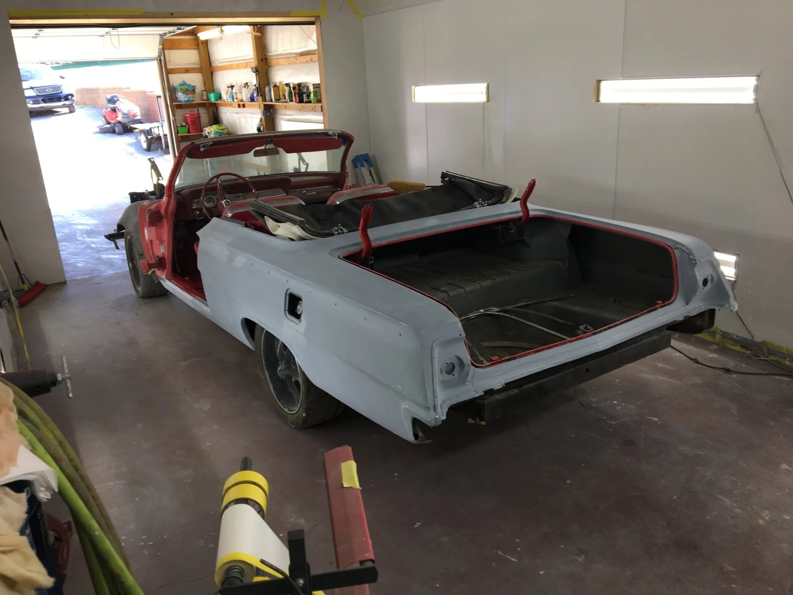

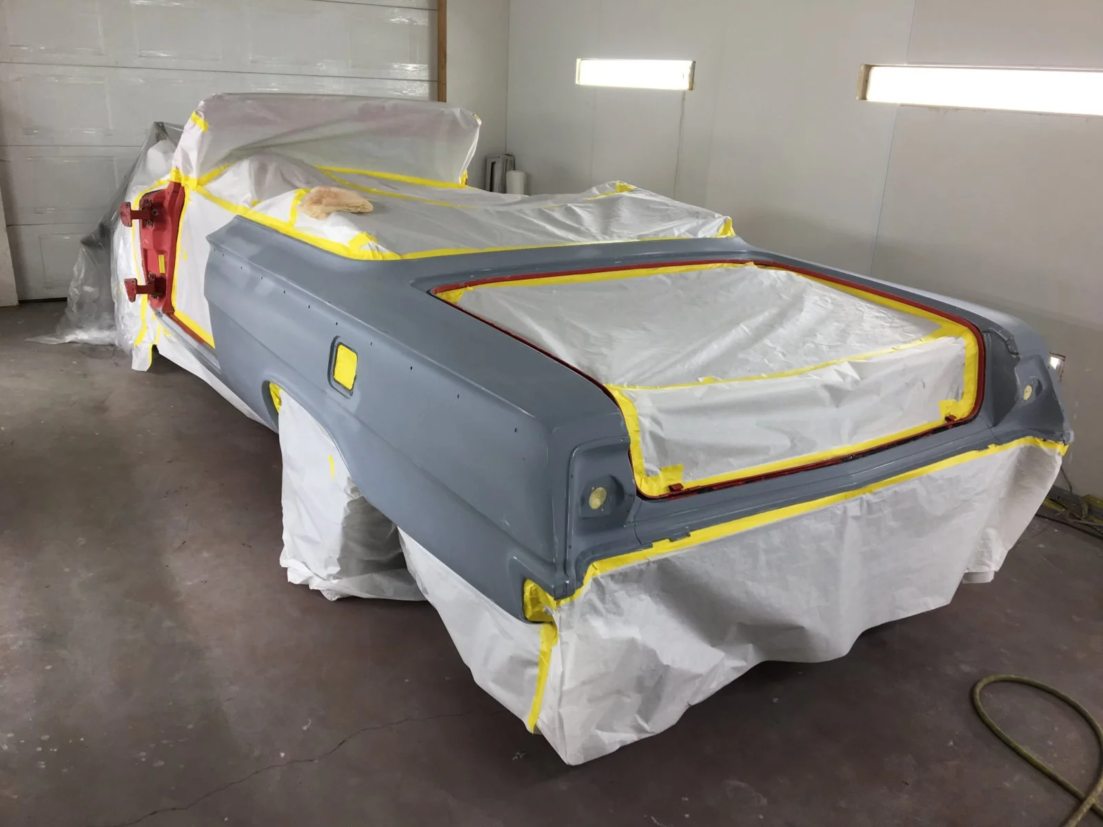

I'm getting ready to go work on the body.
I have about 45 minutes left of prep work to do on it. Found a couple little places that needed to be repimered.
Then an hour or so of cleaning , cleaning, cleaning. Then mask and shoot.
Maybe I'll be done around 2:00ish today.
I don't know how many of you have ever finish blocked an entire vehicle, let me tell you what though, it can make a guy really, really tired.:ack::cry:
Ok, enough whining, I'll update when it's painted.

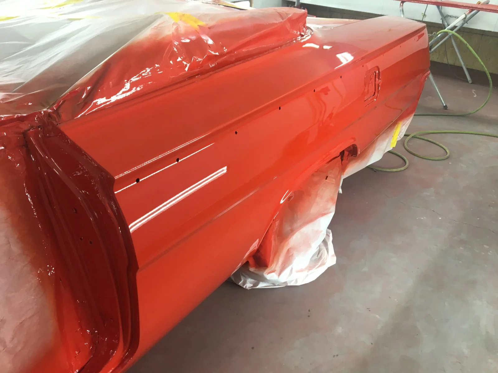

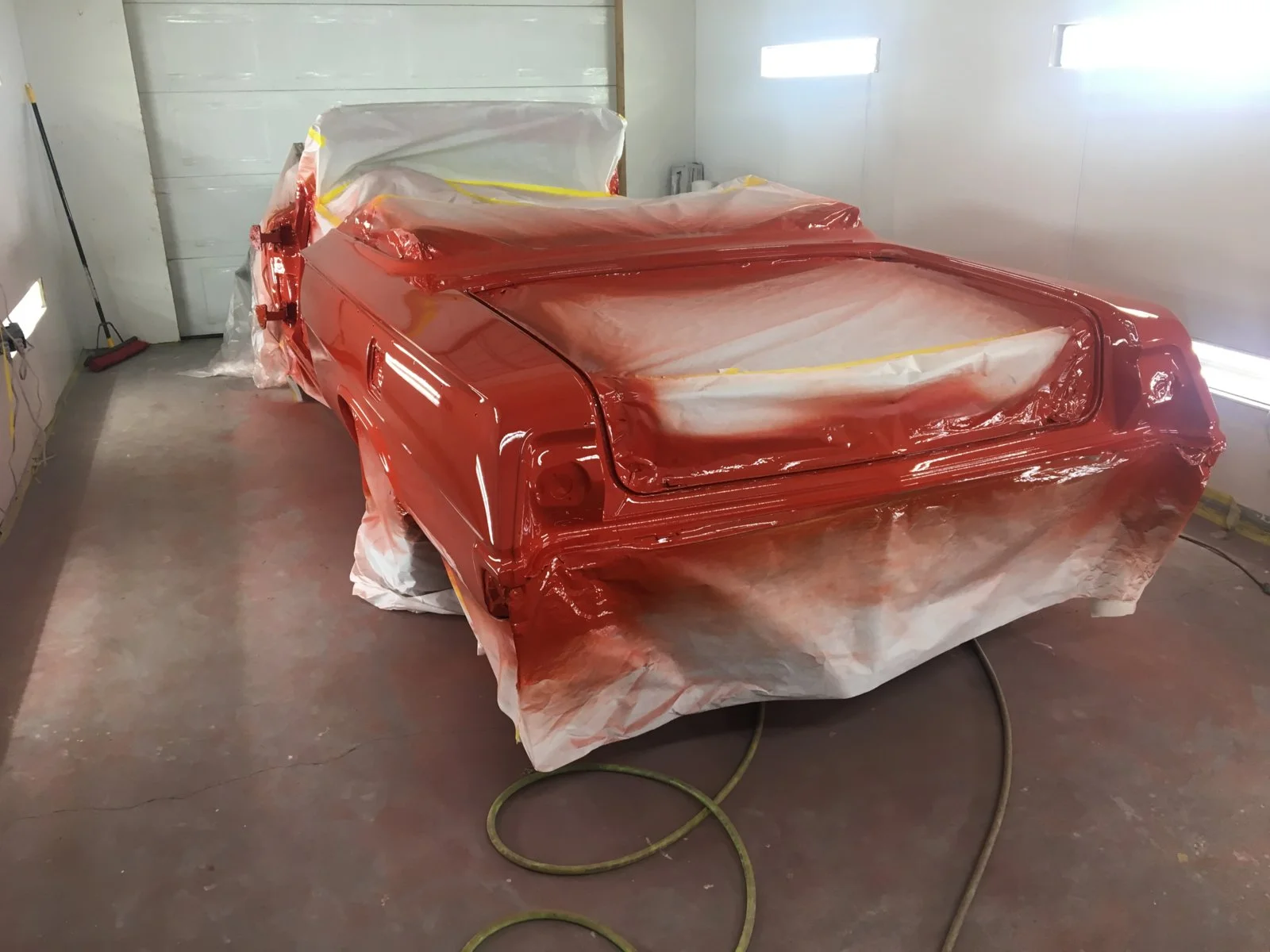

Body is prepped. Luckily it’ll be 95 today and the humidity is in the 85% level with no wind.:nonono::cry:
So, about an hour to clean, then an hour to mask. Then clean again. So it’ll be roughly noon before I shoot it.
Luckily I have a bunch of slow reducers an hand. The humidity makes it go slower almost like it was cooler. The solvents take a bunch longer to leave the paint. So long delays between coats, which works out favorably in this heat.
