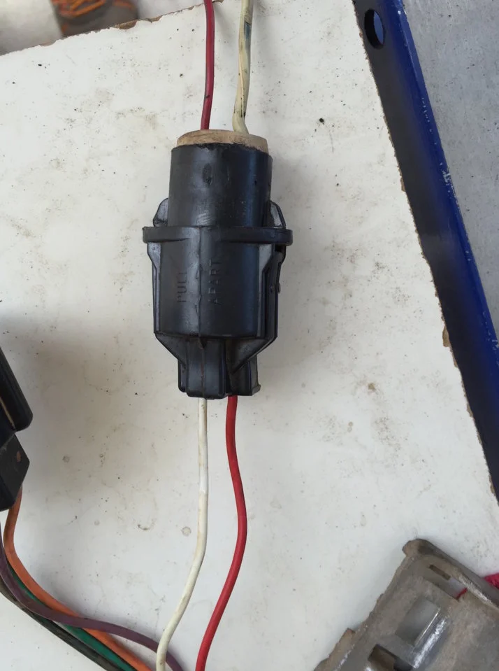

I got it running after a few attempts today. While standing there pondering the wires, I noticed that in the 2-wire plug from the Duraspark box the red and white get reversed! So now I hooked the red to the S terminal and the white to the brown wire plug which was removed from the I terminal.
