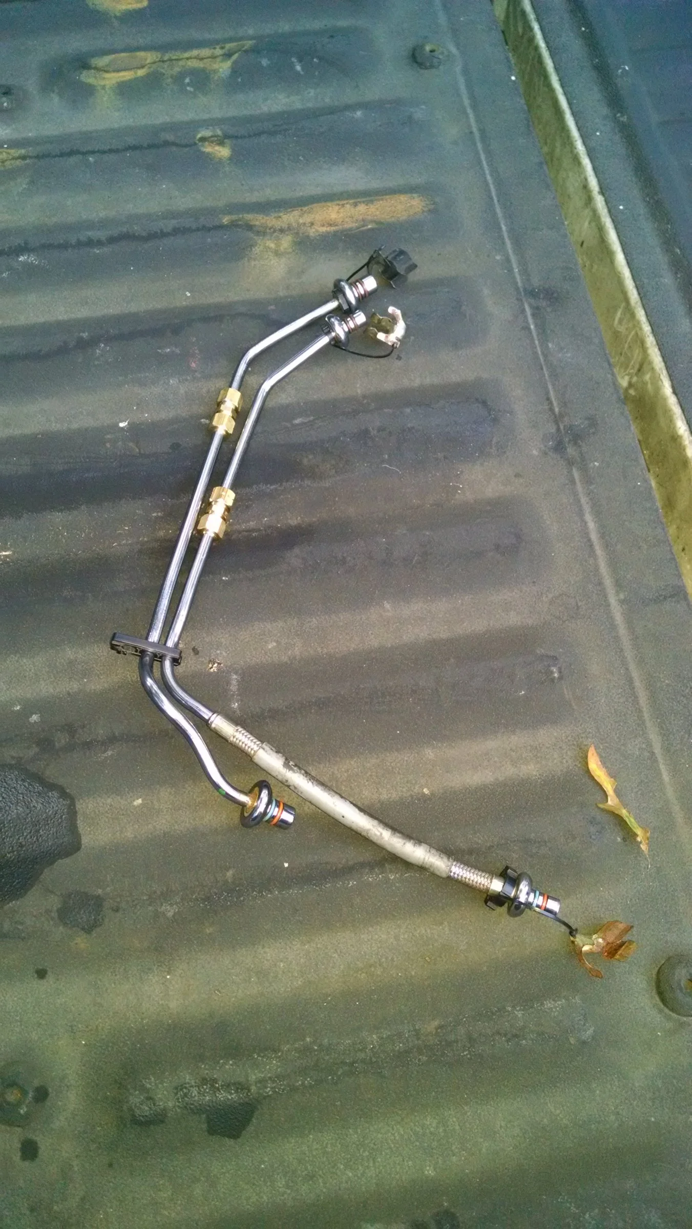

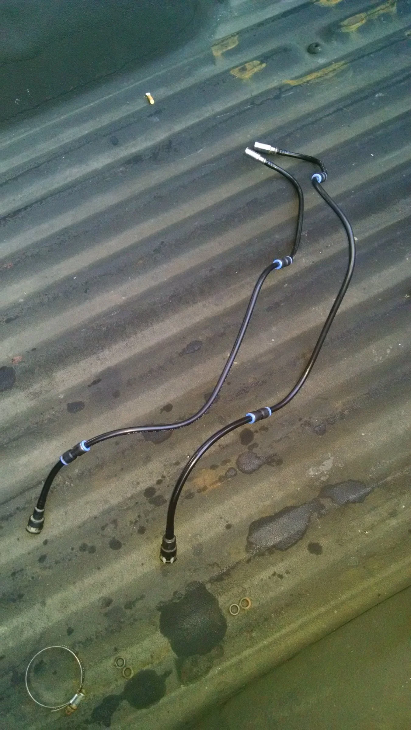

To those that are wondering....these are the old lines I screwed up on. The fittings on the lines are nylon fuel line repair couplers from Autozone. These lines ran from the 4 cyl. body on the drivers side to the metal lines beside the turbo....way too big a chance for failure.

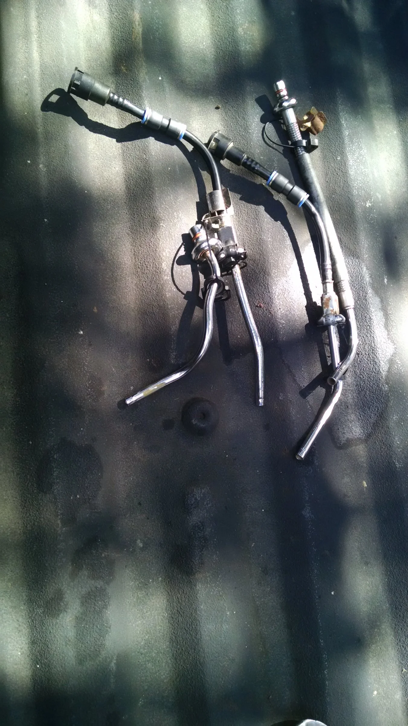

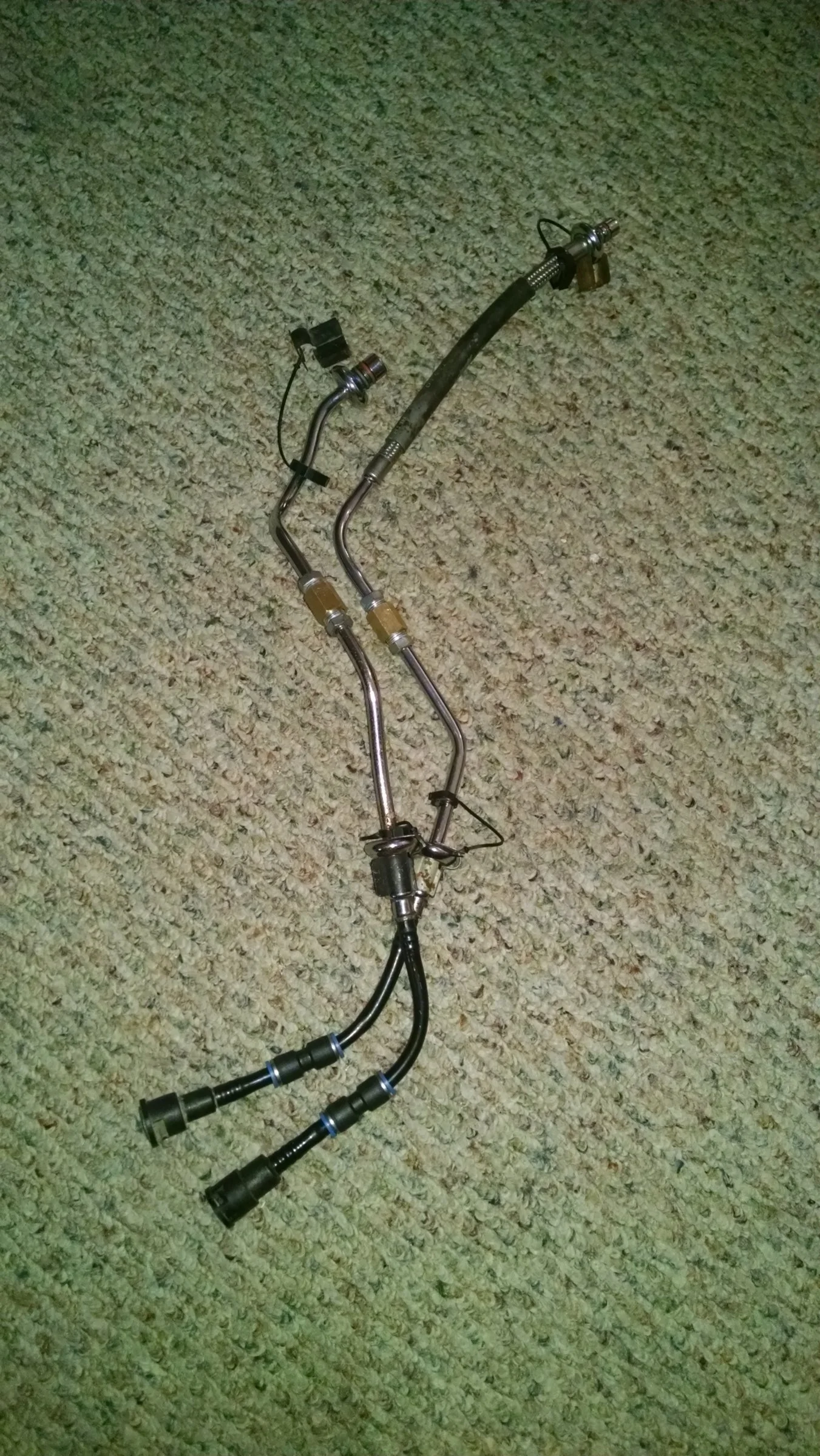

These are my lines made up of partial 5.0 and Explorer lines. There will be a short nylon piece running from frame on left side to new metal lines on left side of block ( 5 inches )....way away from the turbo.

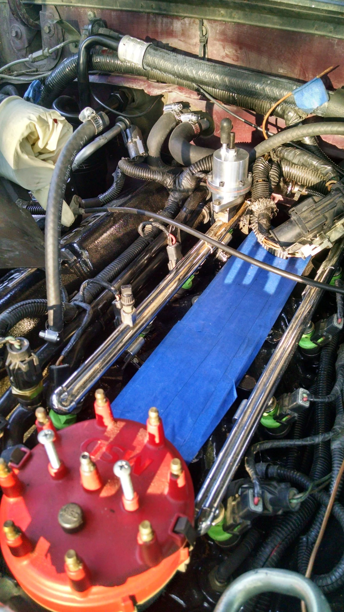

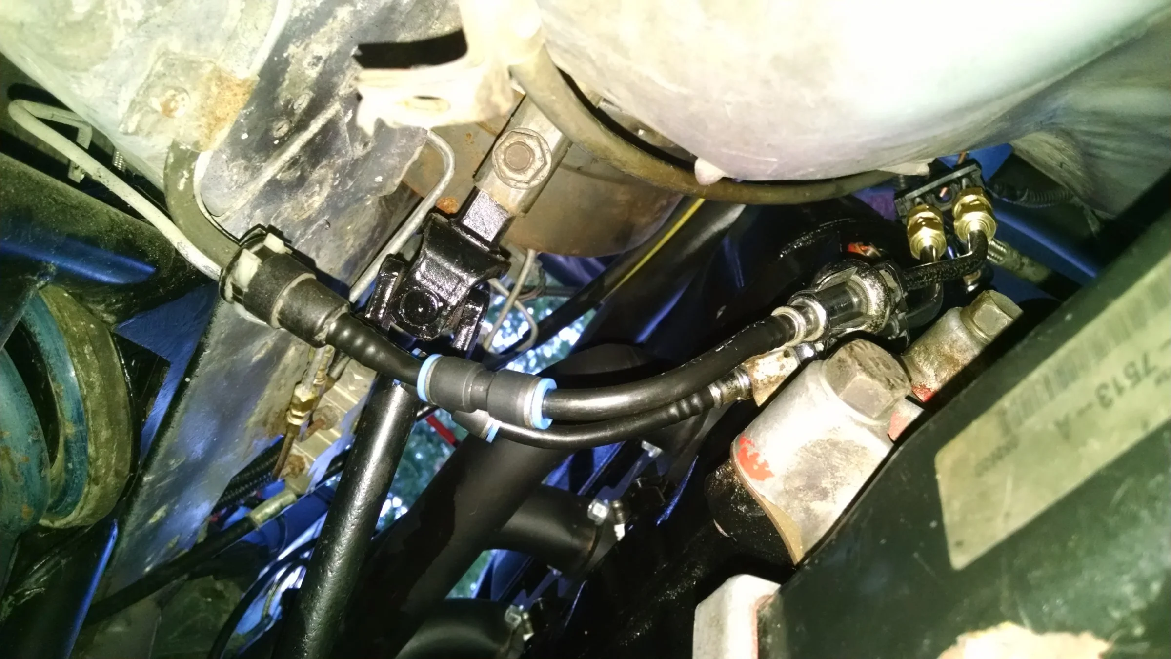

Got the lines in, finally. I'm not a big fan of compression fittings on fuel lines but we'll see how this goes when I pressurize it this weekend....or tomorrow...which ever comes first.

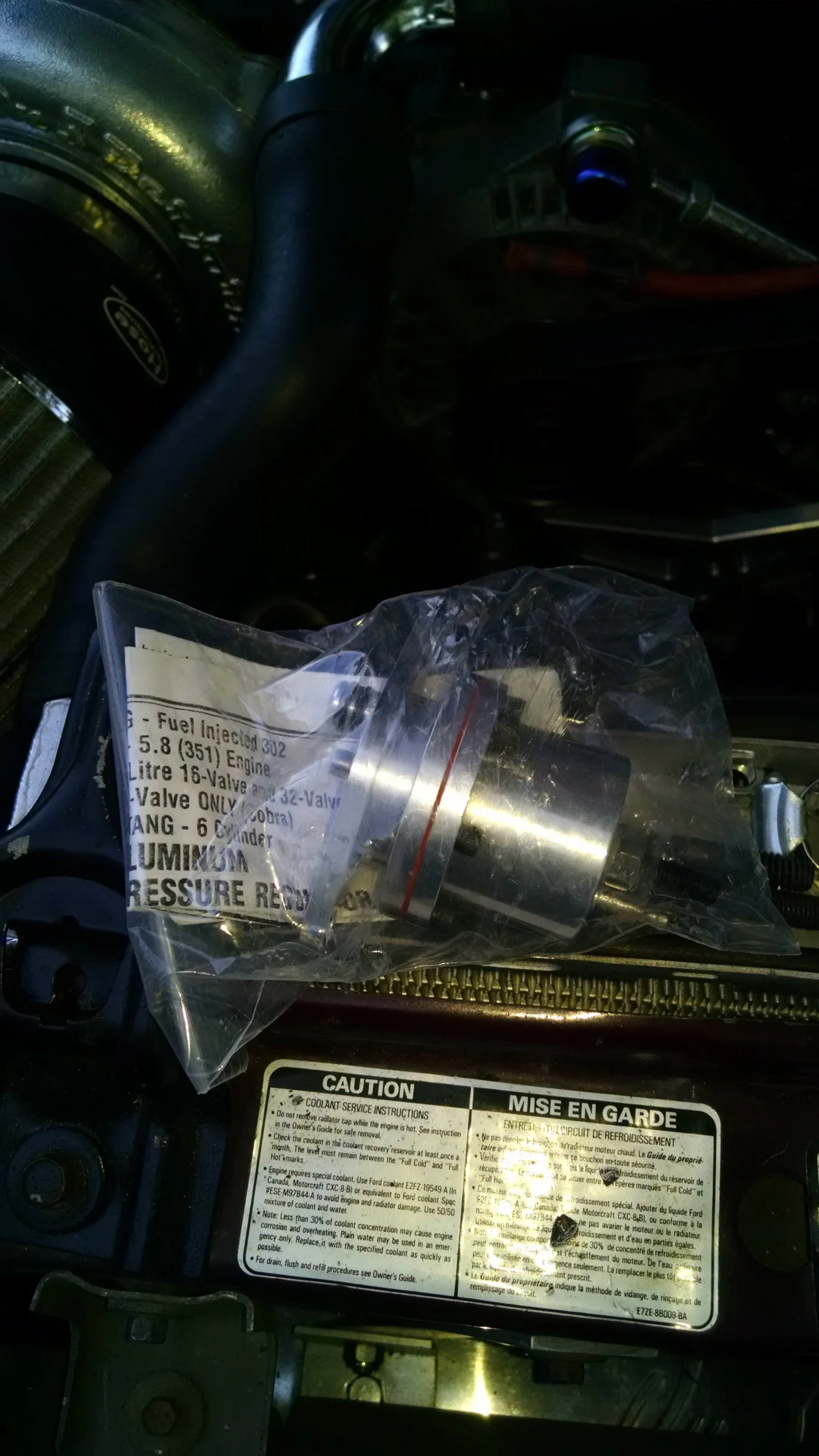

I got the LMR discount code from Dustin but haven't ordered the FPR yet.

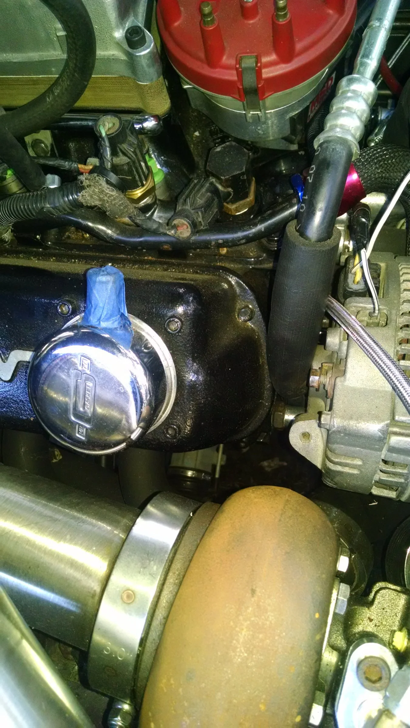

I swear it feels good not to have fuel lines running behind the alternator and the turbo. If I only could find something to do with this AC line. Smh
Do yourself a favor and get rid of those mr. Gasket valve cover breathers. Go get a couple of valve cover breathers off of a 95 Dodge Ram 1500 with a 5.2? Anyway these won't leak but those will.
I'll look for one this weekend. These are the sealed ones ( no holes in the bottom. I have seen the Mr gasket ones leak, but this one is made from another manufacturer ( I think ).
