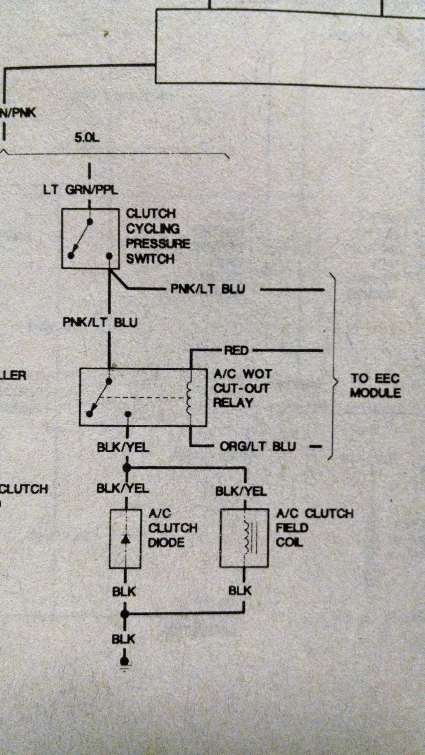

Its working right but the computer is sending ground to pin 54- orange/ Lt blue going to the relay. Pin 16- pnk/ Lt blue is batt + coming out of the pressure switch. ( letting ECU know its on )
A green/ purple goes to the HVAC control switch to pressure switch ( batt + )
The red wire comes from the ignition batt + feed for the ECU ( orange/ blk changes to red ).
Normally, when the relay is not energized, the relay let's batt + pass through it. The computer grounds pin 54 all the time in KOEO or KEOR.
The stock computer would ground the relay, cutting power to the ac clutch, under WOT through pin 54. Pin 16 is the AC on monitoring pin.
I have batt + at pin 16 only when AC is on...that comes from the output from the pressure switch.
I could cut the 54 pin wire and use a micro switch to supply ground to the relay....but that wouldn't be the correct way :shrug:...if MS uses pin 54 for AC relay control ( like the stock computer )

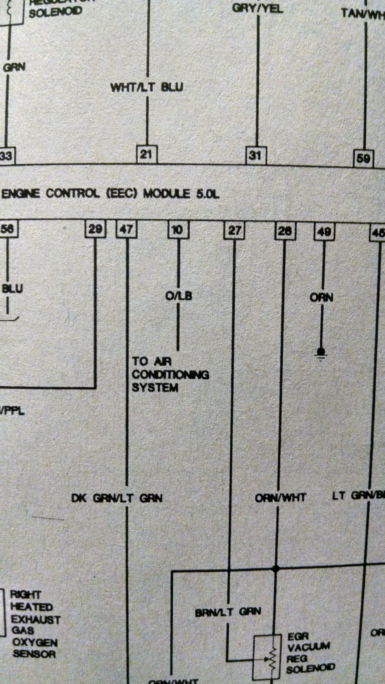

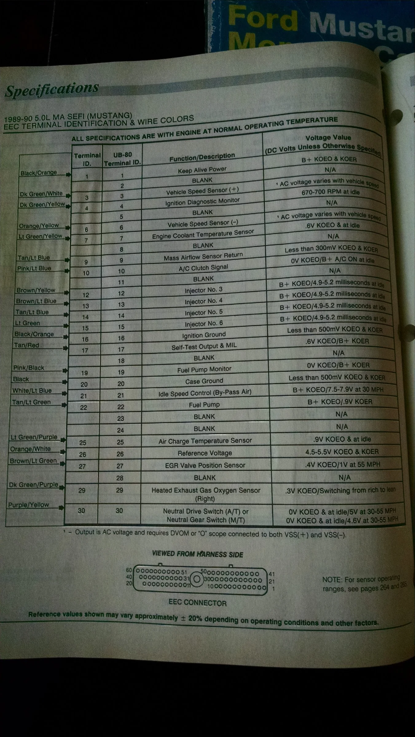

I found info for jumoing for AC idle up function. My book says pin 16 for pnk/blu .... I'll have to double check that while I'm in there.
Somewhere I found a complete mspnp2 EEC 4 computer pin list. I updated my phone and lost all my bookmarked links.

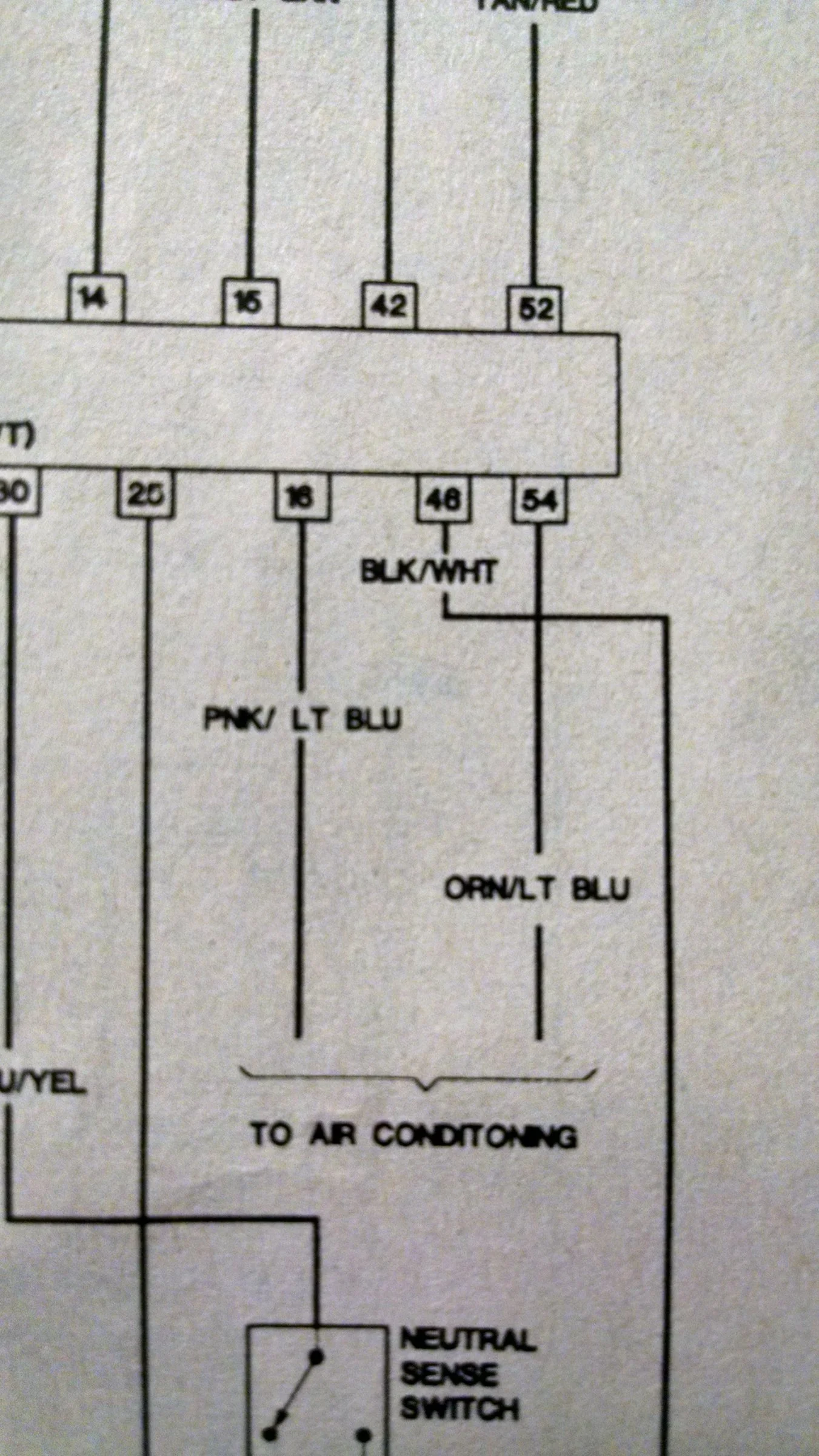

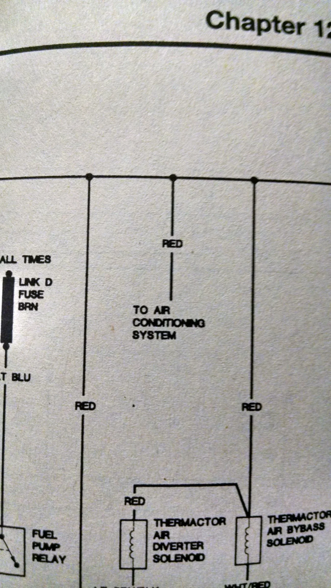

My schematic book shows pin 10 o/ Lt blue and pin 54 o/Lt blu both going to AC. Pin 16 shows pnk/ Lt blue going to AC .
Just some pics of the schematics in case someone else needs them too...

The schematic in my service manual was wrong. The AC pnk/ Lt blu signal wire runs to pin 10 on 89- 90 v8 mustangs. Pin 54 org/ Lt blu should have 0v koeo and koer w/AC on at idle should be b+. My MS supplies ground when ac is cut on...in turn activating ac WOT cut.

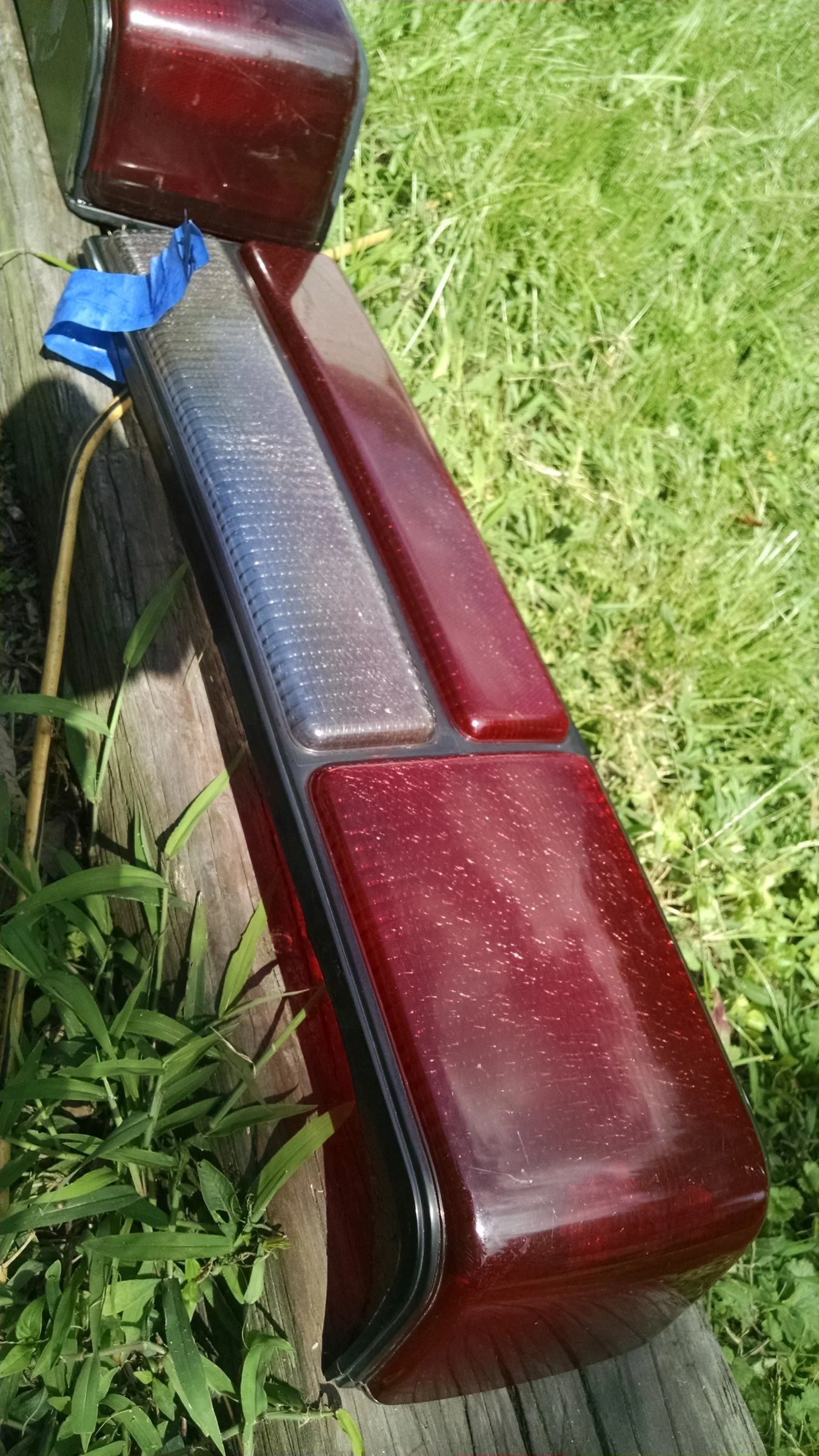

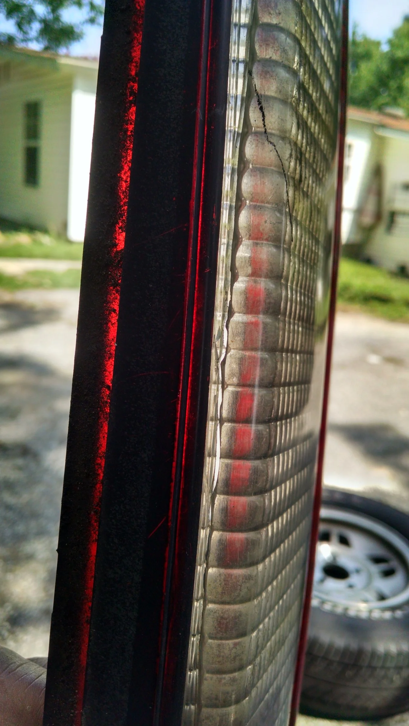

I bought a tail light recently but its got fine cracks all over it. I'd rather deal with one big crack. It wasn't a total loss though. The housing behind the drivers clear tail light is broken right where one of the retainer clips is supposed to be.
I can now fix the clear ones....clean them up and post them on CL for sale.

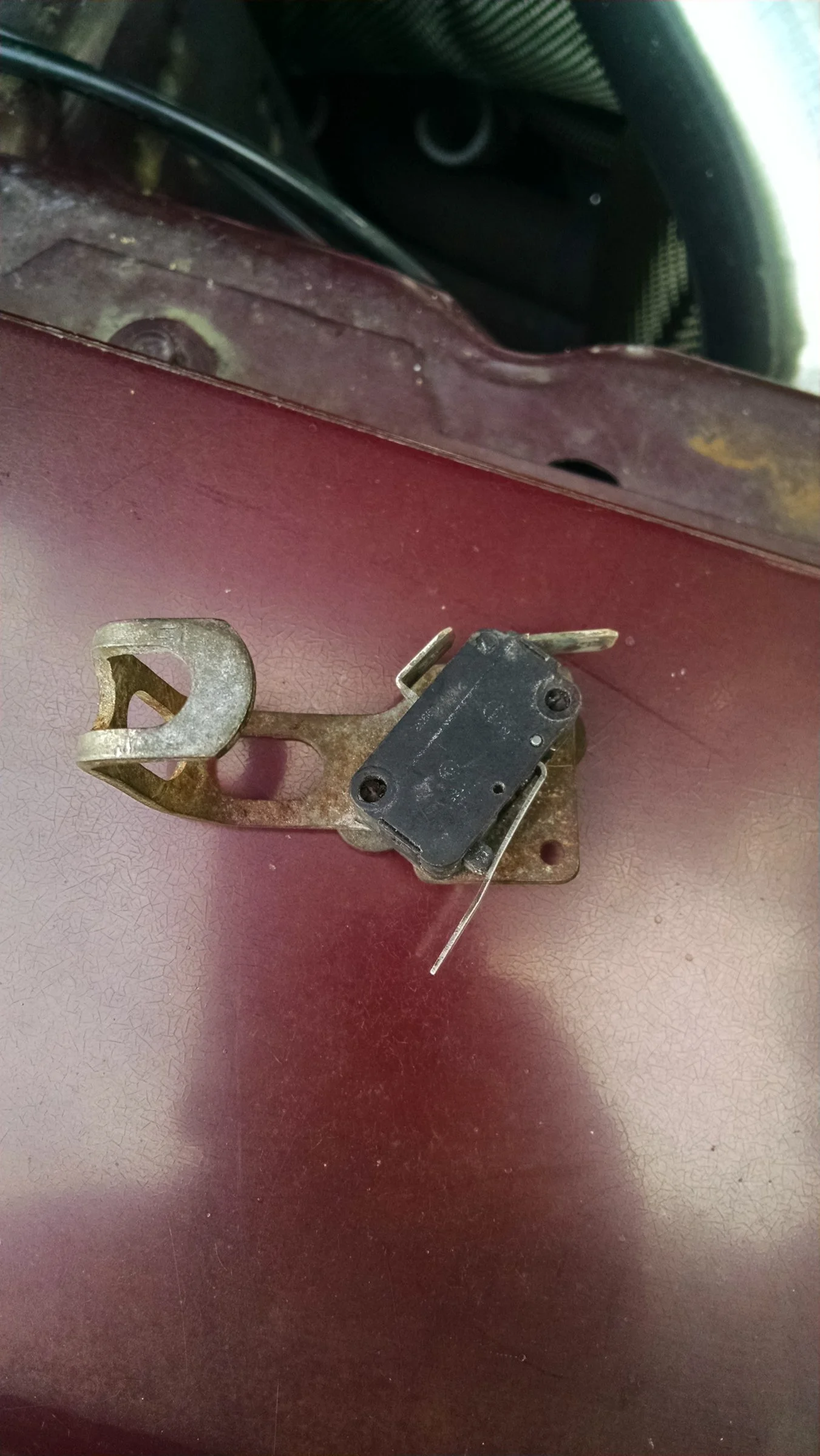

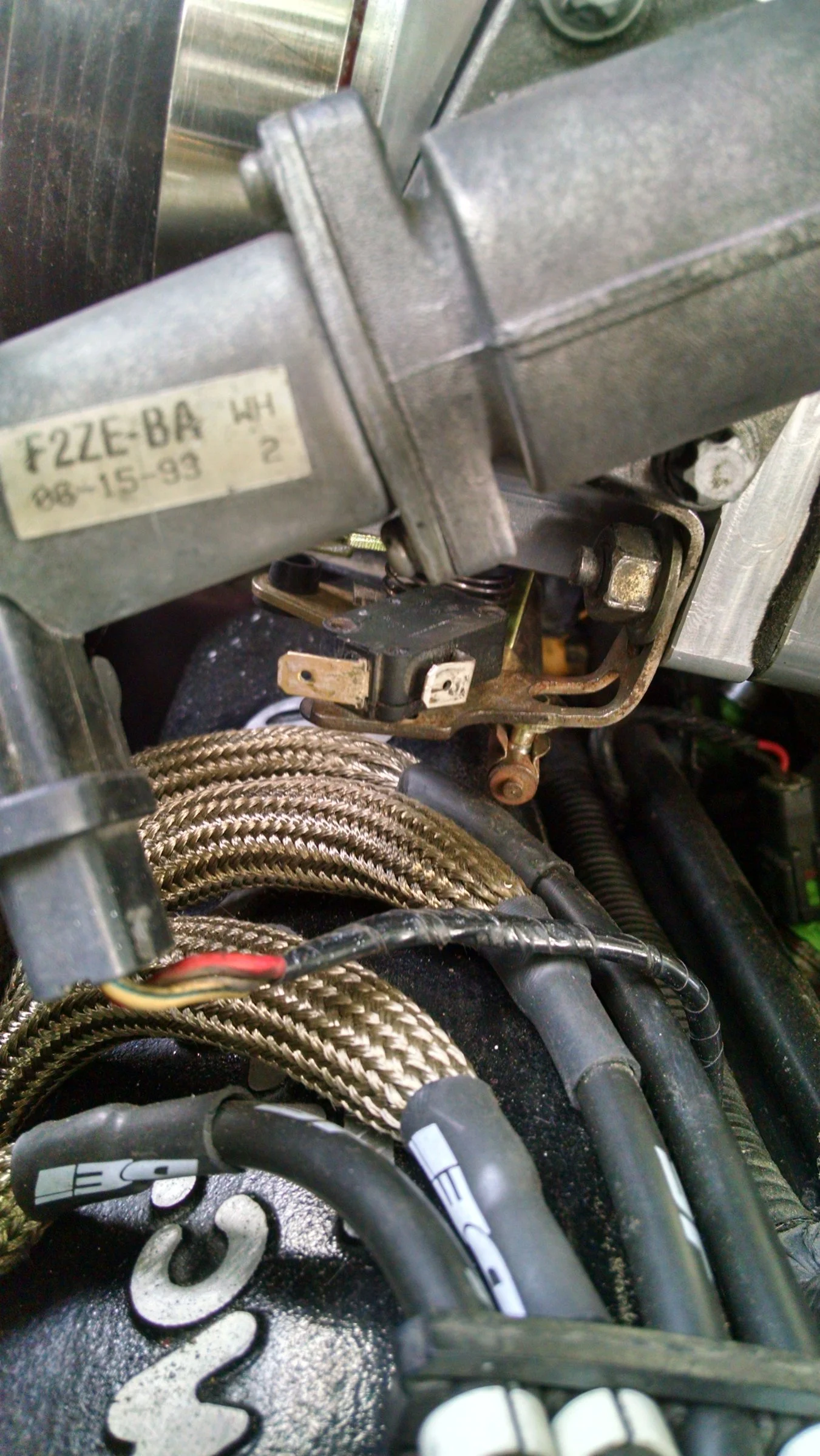

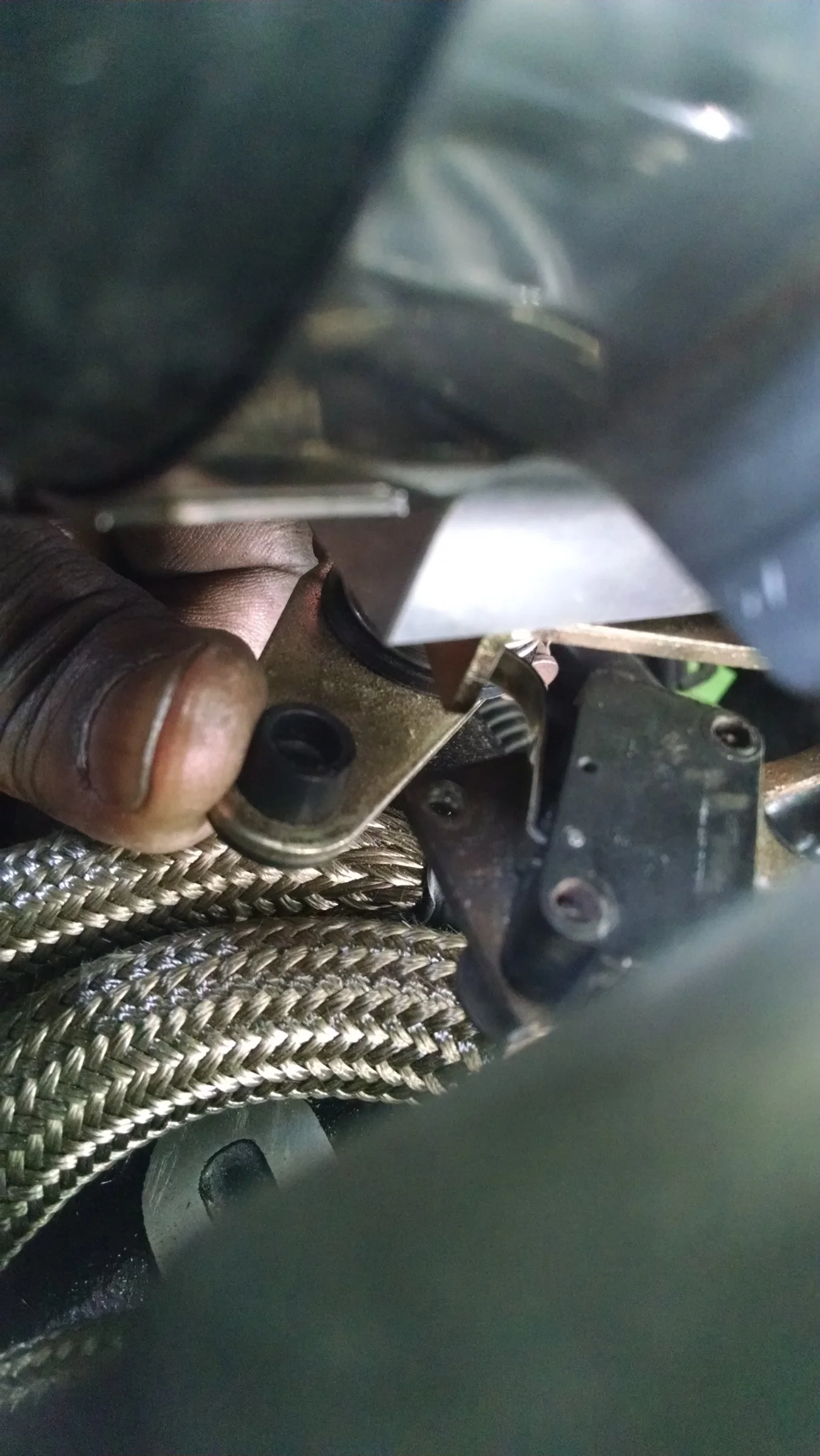

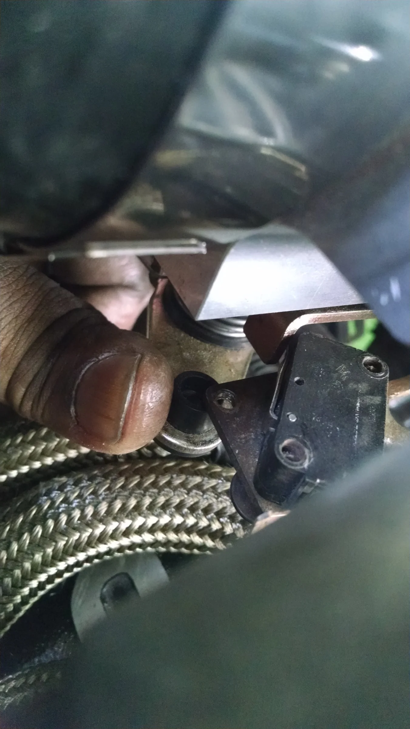

Got my old nitrous switch installed and adjusted for the AC. It'll cause eyes to search for the nitrous jets. Lol
Part throttle....
Full throttle
