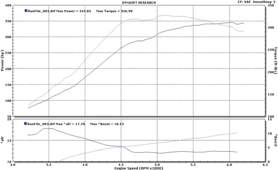

Tell me what you think

DAMMIT, you have 15 more HP's than me.......
haha what do you got done? head/cam swap?

Is that a supercharged application? Maybe a vortec? The numbers seem really low.

Who posts a dyno graph with no other info?
+1 if your really making 10lbs thats weak, is this a non-pi? Im making more than 60+rwhp with about the same boost.

"04 Ford" by your profile. I'm guessing heads/cams.

If I remember, this car is bone stock with a vortech, in which case the numbers are close, or maybe just a tad low.

It states "max boost" in the graph so it's definitely a FI application. I really hope this an NPI car because those numbers are horrible for 10psi.
10psi even on a bone stock PI 2V should yield more than 345rwhp.

My friends car running a 10lb vortec put down around 370 to the wheels.

Sorry, is an 04 mustang gt automatic with a vortech V3. At the time of the dyno the tranny was slipping very bad, three days later tranny broke. I think a slipping automatic tranny has to do with the low numbers. With more timing we got about 360ish. Now that the tranny was rebuilt I want to try again.

boost curve screams centri. blower, when you see a roots blower it comes on at 3K and by 3,500K its maxed out.
that v3 is one nice unit though, keep your foot in that gas
