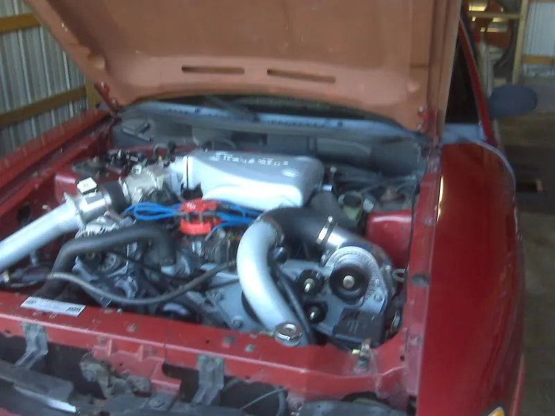

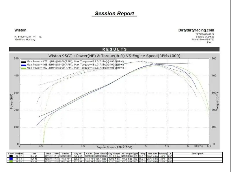

331 DSS stroker Trickflow top end kit stage 2 cam , D1SC procharger 11psi , Detuned to stay under 500 rwhp so it doesnt split the block , tuned with Moates Quarterhorse
475 RWHP 483 RWTQ
