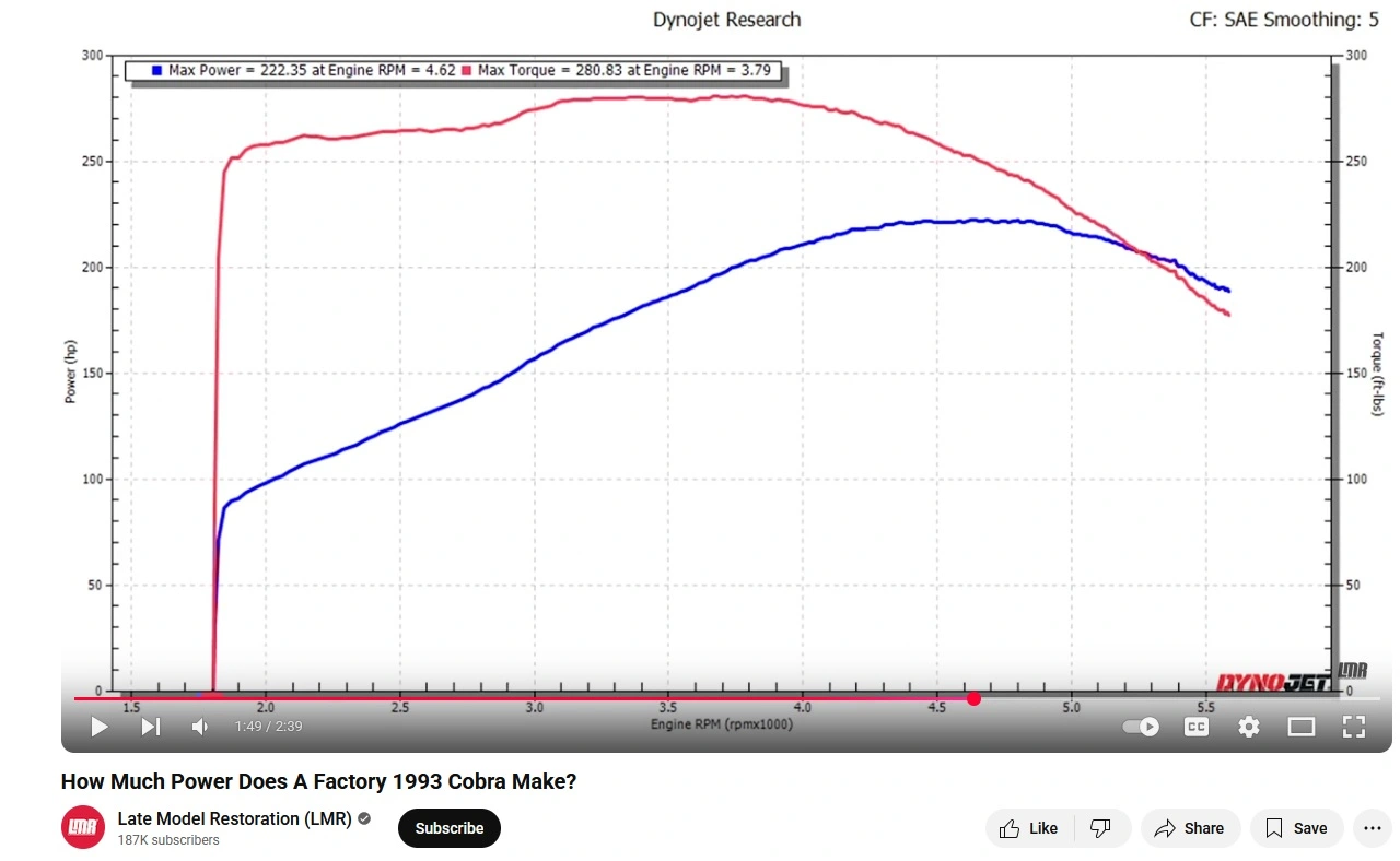

Oh hell no. Stock Cobra's were in the 240/290 range.

Found this on YouTube when LMR dyno'd a bone stock 1993 Cobra:

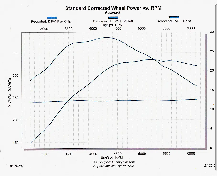

Similar to my 347. I was told my cam is holding me back.
I suppose that depends on your definition of "holding back".
That's obviously a street cam. A stage 2+ cam would push your torque curve to the right giving you a little more peak at the sacrifice of making 350+ ft/lbs at 3250 rpm. :shrug:
I'm guessing your combo is pretty wild on 'throttle blip'. :rock:
As in: Wakes up right TF meow.

Oh it's a terror on the streets for me and first gear with my 3:73's is non existent. Unfortunately I have no info on the cam. I bought the short block already built and lost touch with the dude shortly after.
