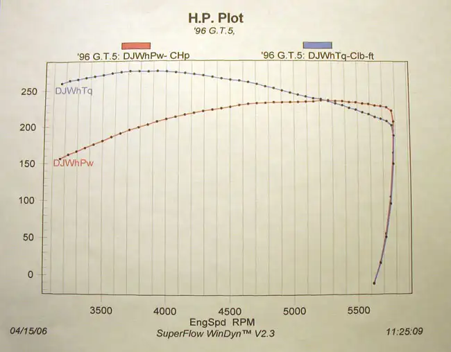

Here's my graph with the about the same mods you have, but you have a little more than me. This was run on 87 octane. I'm going to get a 93 tune one of these days. The numbers are 231/270.
