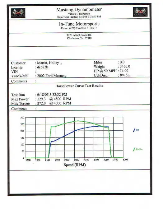

Okay, here are my dyno results. I'm a little troubled by the low numbers, but some tell me this is because it is a Mustang dyno. I don't know :shrug:
229 hp/272 tq means I have gained roughly 40 hp w/ my few mods. I was hoping this to be more. Any comments/suggestions?
My future plans include headers and possibly cams.

They say Mustang dynos usually have lower numbers because it puts more load on the car. No A/F ratio? Also don't gears make the reading slightly smaller too? Not for sure on that one. Did they do the pull in 3rd or 4th gear?
Where are you getting you gained 40 hp?

I'll have to scan my other dyno sheets if you want to see the a/f ratio and other stuff. I only scanned the hp/tq results page. I'm not sure if gears make a difference. The pull was in 4th gear -- we ran it up past 100. And we made prolly 5 or 6 different pulls. He attempted to tune, but really the 93 octane Predator tune was about as good as it was going to get.
I believe I've gained close to 40 rwhp if you consider that stock my car had 260bwhp at the crank which converts to maybe 182 - 195 rwhp stock. Anyone dyno a stock 4.6 at a Mustang dyno? I would be curious to see if this is accurate.

Mustang dynos = great to tune the car
Dynojet Dyno = ideal for seeing what your best #s are.

229hp with those mods? :scratch: Damn that mustang dyno really does show some low numbers...thats stock numbers!!

Still don't understand why the MD cannot turn off this "tune mode" or whatever it is that's causing the error and simply measure and display the actual power being delivered to the wheels. The elegant simplicity and determinism of the Dynojet makes it the benchmark - at least compared to the MD - for showing what power is there at the wheels.
As if that car, with those mods, is actually making just 229. For deltas during tuning or measuring A/F at steady state load, I can see the MD being useful. But why would anyone want to use something that's clearly not reporting the correct numbers for determining absolute power at the wheels?
What was the weather like? Was it hot and/or humid? If it was, that would affect engine output. I didn't see it on your scan, but there usually is a correction factor that allows for temp & humidity. Look for something like SAE 1.03 (that's what mine was, air temp was 93 deg w/18% humidity--hp was 229 corrected was 236) then do the math and you should get a better idea of your true rwhp. There's a good article on dynos and how to use a dyno in the current issue of Grassroots Motorsports. Hope this helps.

Those numbers are really quite good being on mustang dyno. That equates to 250ish on a dynojet.
I agree with this. Your numbers do seem pretty good considering what you have done to your car. Powerwise you have a Predator,x-pipe, and catback. That really is not that much...but you got good solid gains. Too bad you don't have a stock dyno sheet.
When I bought my car new, I took it to a local shop that does a lot of Mustangs, to get a basline set of numbers. My stock N/A Saleen has about the same mods, plus U/D pullies, but had cats. My numbers were really close to yours, and they were pretty impressed. I didn't ask them what a stock GT normally gets on their dyno though.
Those are good #s for a mustang dyno. I actally raced a guy that put down 237 and 274RWTQ on a mustang dyno. He had O/R X, flowmaster CB, custom dyno tuned W/ sct-4 bank, mac straight shot, accufab pleunum & TB, and UD pullys. Needless to say we were even. BUT thats just an example, mustangdynos are the best for tuning and should not be used to compare HP #s. If you notic, he entered your weight of 3450, and thats what the dyno loads the car to. If you changed that weight any, the #s would vary...so you never know what weight people enter with these. But IMO the #s are pretty good, as 4.10s USUALLY loose about 10ish RWHP. And would you mind scanning the other sheet that contains your A/F and the other various #s that the mustang dyno includes. thanks

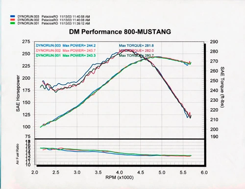

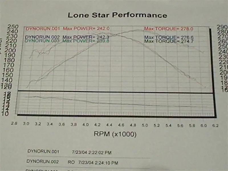

Those look like nice numbers to me. I would say ditch the predator and go with the SCT X2 tuner. I have an 2003 5-speed GT
1st graph is with a Prochamber and Mac cat-back
2nd graph is with the addition of the Predator performance tune
