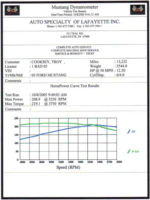

Just got my car dyno'd Sat and pulled in a 208.9 hp @ 5250 RPM and 219.1 lbs of torque @ 3750 and a 14.3 1/4 mile[:D]

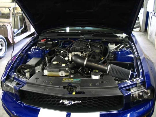

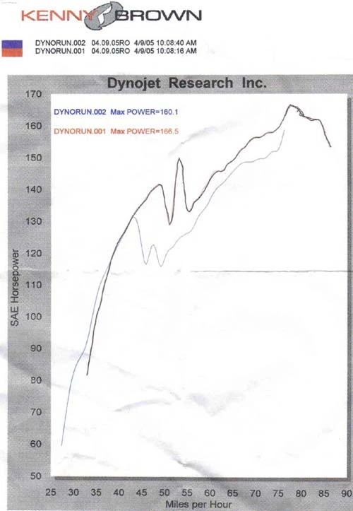

I have 2005 Mustang GT cat back duals which I got about 6-8 hp from but the big gain came from my CAI from Tunable Induction and an XCal tune from Blow by Racing. Tha new cold air looks and works great and TI has a great product and price. Here's some images of my original Dyno and my new dyno Sat (thanks to Greg @ Auto Specialty in Lafayette In) plus a pic of the system on my car. PM me if you have any questions

Were the "before and after" dyno runs done on different days/dynos?

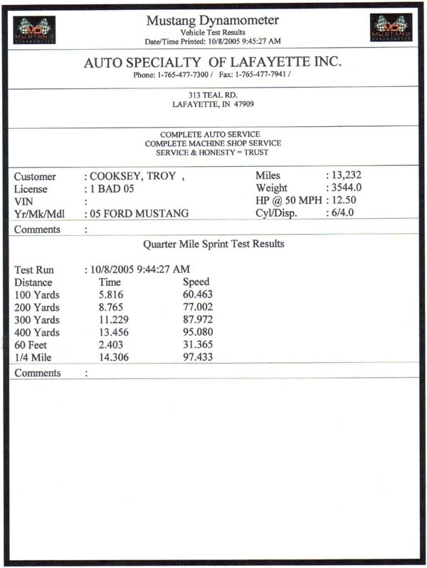

Isn't that a "virtual" 1/4 mile? Meaning, done on the dyno---not sure how realistic those are...???
The results were on different days and dynos.
I'm deducting 17 rwhp to account for this variable along with the exhaust mod.
This way the gains are REALISTIC, not advertising hype.
You could get +32 rwhp for the system / tune deducting 8 rwhp for the exhaust. I'll deduct another 7 rwhp for different dyno, gas quality, etc. variables.
I'll relate that customers can expect +25 rwhp increases (CAI w/ tune) and as more dyno feedback is received it will be correlated for gain consistencies coinciding with these variables.

I guess my science background says that the best control would have been to run the car stock again on the same dyno, same day, same tune with factory air box, and then slap on the CAI + tune adjusted for only the CAI. Then you can say precisely what the CAI gains you. Otherwise, there are too many variables in the experiment (which this was, really...)
And of course, run each 10 times, get the mean, and do standard errors/etc. :D
Anyhow, the CAI looks really nice and I trust it gives the car a good boost. :nice:
The upcoming SCT tune will be stock / stock w CAI /tune same day, dyno and I'll relate these gains also.
These and other forthcoming results will establish a credittable baseline.
But 208.9 rwhp on a Mustang dynomometer with keeping the cats and tune/CAI is still 208.9 !!
Yeah, I'm going on some faith with that. But still, good numbers for the HP and torque.
Do you plan on taking it to the track for some real world times, Cheysdaddy?
I'm thinking the 14.3 is ummmm... very optimistic... Based on my observations and others those type of mods and numbers are going to put the car in the upper 14's... 14.7 to 14.9 range... not the lower 14's.... Only way to tell for sure of course it take it to the track... LOL
