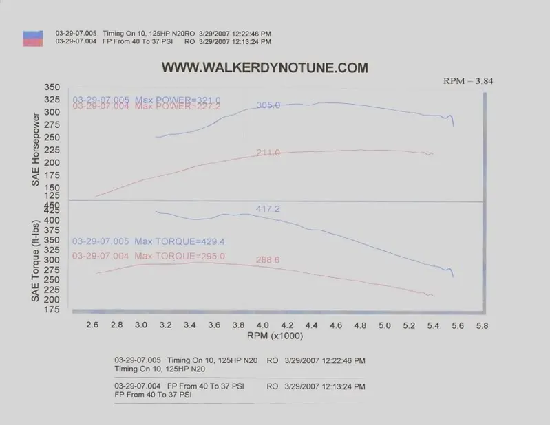

well here they are n/a and 125 shot of nitrous what do ya'll think.

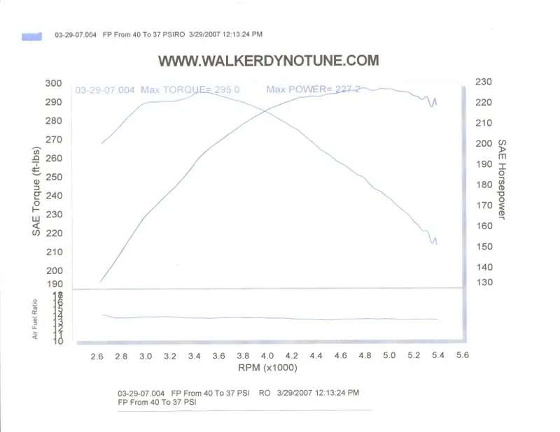

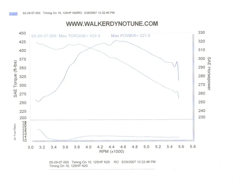

Looks right on... is there any way you could get the actual numbers from the pull? First off, Grady wants to make a chart, and secondly, when the number scales are very different from Trq and Hp my eyes start to cross and I have a tough time with it.

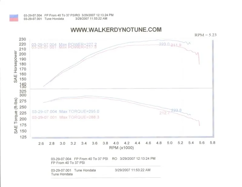

the red results are the first run N/A and the blue is the last N/A run which has a approx 10 hrs. pwr. gain we did this first then run a 125 shot nitrous run and the first run on nitrous looked good for my setup and that is where we stopped the tuner said he can't get much better than the above nitrous results..also on the last N/A results the fuel pressure was dropped to 38 psi. and timing was set at 15*...for nitrous run he simply dropped timing to 10*...
and here are the rssults of the best N/A result (red) compared to the nitrous run (blue)....
