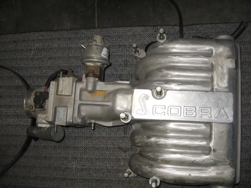

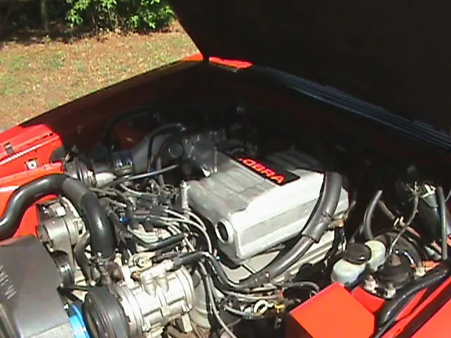

Just installed a cobra intake last weekend got it on the dyno today went from 212whp to 225whp and torque stayed the same at 270wtq...but I gained 15whp and 16wtq from about 3500 rpms and upto about 5900rpms. Will post sheets as soon as the dyno gets some ink.
and I only paid $190 for a orginal cobra intake.
Power Mods are underdrive pulleys, c&l maf and tube, cobra intake, offroad x, magnaflow catback.

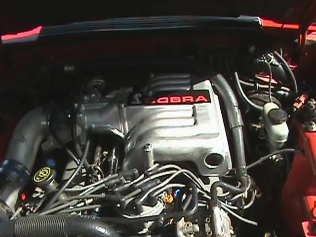

picture of what it looked like before I got it
