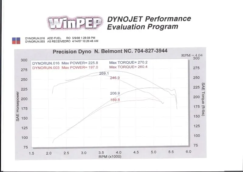

Before and after mods.
The low numbers are before I modified anything(except for the timing, K&n panel filter, and air silencer.
The high numbers are after mods
timing, panel filter, air silencer, underdrive pulleys, c&l maf and intake tube, cobra intake, offroad x pipe, and catback.
these are the gains in the dyno at the given rpms.Note all numbers are SAE corrected
3100rpm (1hp 1tq) 3200rpm (3hp 5tq) 3300rpm (4hp 6tq) 3400rpm (4hp 7tq) 3500rpm (5hp 7tq) 3600rpm (7hp 10tq) 3700rpm (9hp 12tq) 3800rpm (11hp 15tq) 3900rpm (13hp 13tq) 4000rpm (16hp 21tq) 4100rpm (19hp 24tq) 4200rpm (22hp 28tq) 4300rpm (24hp 29tq) 4400rpm (26hp 31tq) 4500rpm (28hp 33tq) 4600rpm (27hp 32tq) 4700rpm (31hp 34tq) 4800rpm (30hp 33tq) 4900rpm (29hp 32tq) 5000rpm (31hp 32tq) 5100rpm (32hp 34tq) 5200rpm (35hp 35tq)
