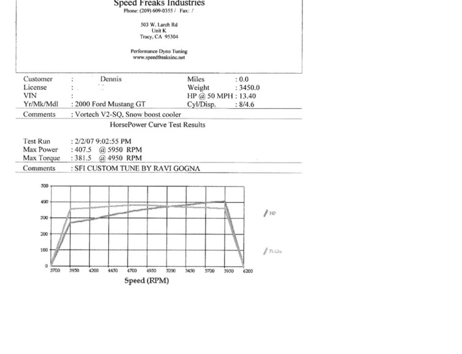

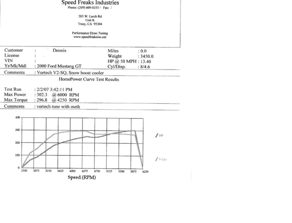

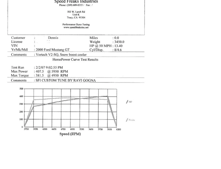

Alright guys, just posted on corral, but thought I'd post my dyno results here also. Went to SpeedFreaks Inc in Tracy, CA and Ravi did a phenomenal job tuning using SCT with 4 setting chip (Thanks dude!) :D This is for a 2000 GT vert with stock internals, 30lb injectors, and stock MAF.
Baseline (Vortech V2-SQ w/o meth): 315 rwhp

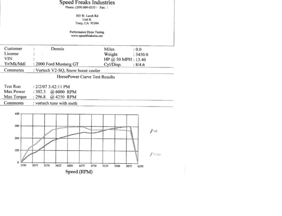

Baseline (Vortech V2-SQ w/meth): 302 rwhp
Assuming 15% hp loss due to drivetrain, this puts the baseline Vortech at roughly at 362...roughly what Vortech advertises. As expected, the Snow Boost Cooler w/o a tune lost HP because of an over rich state (plus a bad Vortech base tune...A/F ratio dipped to the 9's...yikes!)
After some magic by Ravi, the final RWHP numbers are:

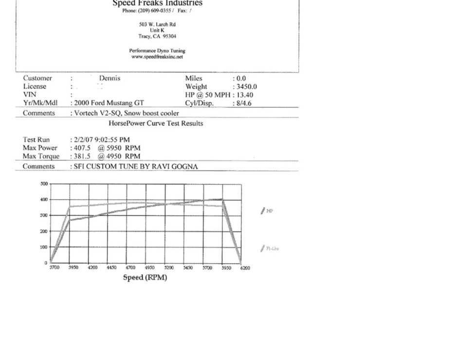

Final (Vortech V2-SQ w/ meth): 407.5 rwhp!
We decided to be safe and backed things down to 392 rwhp for the most agressive tune. Until I get some forged internals, I'm happy with the results. Now how the heck do I post the dyno graphs?

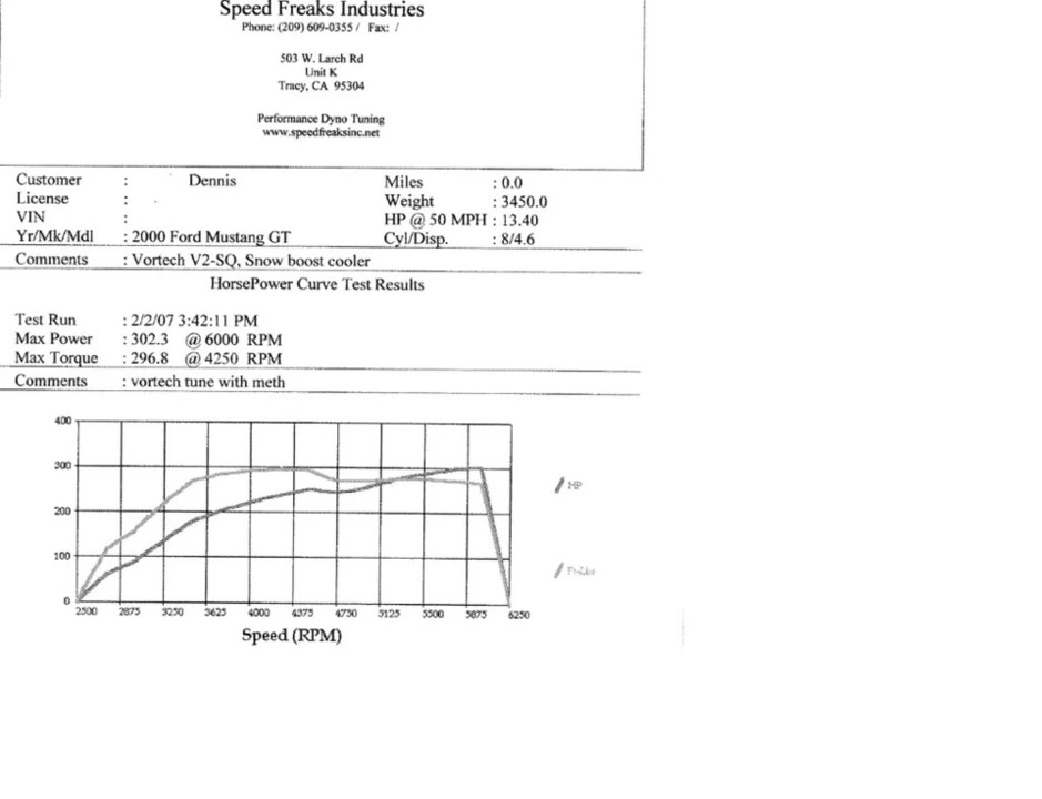

Thanks for the assist. I posted the dyno graphs below. As far as the injectors, Vortech originally supplied 30lb injectors in 2001, but switch to 36lbs several months later. The limiting factors for my tune were the injectors and the MAF which was pegging at 4.95 volts (5v being the limit).
I'm glad I went with the SCT 4-bank chip and have the ability to switch tunes. Ravi did mention that although people say that you can switch "on-the-fly," he advised to turn the engine off first so the binary files will read properly. I went with the four tunes below:
#1 - Fuel Economy setting, non-aggressive, daily driver tune (342rwhp)
#2 - Optimum tune for Vortech V2-SQ w/o methanol (358rwhp)
#3 - Optimum tune for Vortech V2-SQ w/ methanol (372rwhp)
#4 - Same as #3, but for 110 octane and 91 mix (392rwhp)

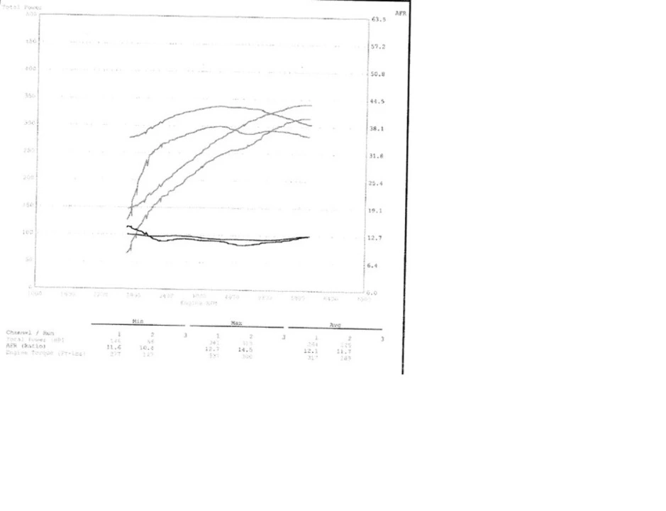

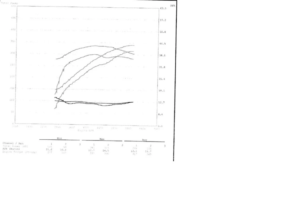

Here is an overlay of the baseline Vortech tune w/o methanol (315rwhp) and the adjusted tune (342rwhp). I learned something cool from Ravi...he said that at WOT, he tuned the injectors to pulse a few miliseconds before the valves open (recollection is a bit fuzzy so I'm not sure how accurately I'm quoting) to cool the valves... Any thoughts on this?
Broson01,
that injector thing you are talking about is a something only a few tuners actually know how to do. Looking at your numbers your tuner Definetly knows how to work it. It takes some in depth software adjustments to do it. CONGRATS...
Do you have the number to the shop you went to, I would like to see what they can pull out of my car..
Thanks
"Timlagallow: ...that injector thing you are talking about is a something only a few tuners actually know how to do. Looking at your numbers your tuner Definetly knows how to work it. It takes some in depth software adjustments to do it. CONGRATS...
Do you have the number to the shop you went to, I would like to see what they can pull out of my car.."
Ravi is a programming engineer by trade and when he started talking about binary codes in relation to the PCM, I was impressed. I've never heard or read any tech article regarding the pulsing of injectors, but man, I'm loving it. The number to the shop is 209-609-0355 ([email protected])
AmBo - the A/F was set at 12.5, but in my excitement, I forgot to ask for the total timing. I can get that info from Ravi along with the video of the dyno tune session. I'll post the video as soon as I get it.

Nice numbers!:hail2: But number 3 is your true numbers. What you can run on the street on 93 octane is what counts.:shrug: j/k Good job. :D I almost went with water/alchy inj. But I'm to lazy to watch it.
Little bit lean I would expect the timing to a little high because water/alchy inj likes the timing.
I just looked on that Speedfreaks website - they use a Mustang Dyno, so these numbers are certainly impressive.
They do usually read lower. But they are also the easiest to manipulate.
