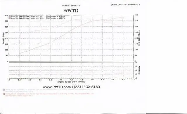

Dyno Numbers of Vortech'd 01 Mustang GT
well i finally got my car dyno tuned after the blower install
mods done to the car performance wise:
Vortech V2-SQ w/aftercooler @ 10 psi
4.10s (i know no gains added with this)
BBK O/R X pipe
Flow40s
SCT xcal2
Max Pwr= 379.07
Max TRQ= 370.24
if anyone could make the dyno sheet a bit bigger for everyone to read that would be awesome... also i'm thinking about putting a built block in my car(the mmr 900)...either that or full bolt ons
Hmm...Significantly better torque numbers than I produced on the Dyno and I have quite few more mods. Other difference I see is I have P1SC-2 with 8.6 psi at 5600 with a tune that is a little on the fat side to be safe. 386 rwhp @5600 rpms, 358 ft lbs rwt.
the numbers look average to me. i'm assuming your tuner kept the tune on the safe side for the stock internals. for reference, i made 380rwhp/380rwtq at 10psi with the same blower but without the aftercooler and thru an auto tranny. that was at 16* timing and 11.0:1 a/f ratio.
