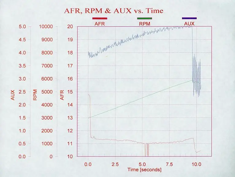

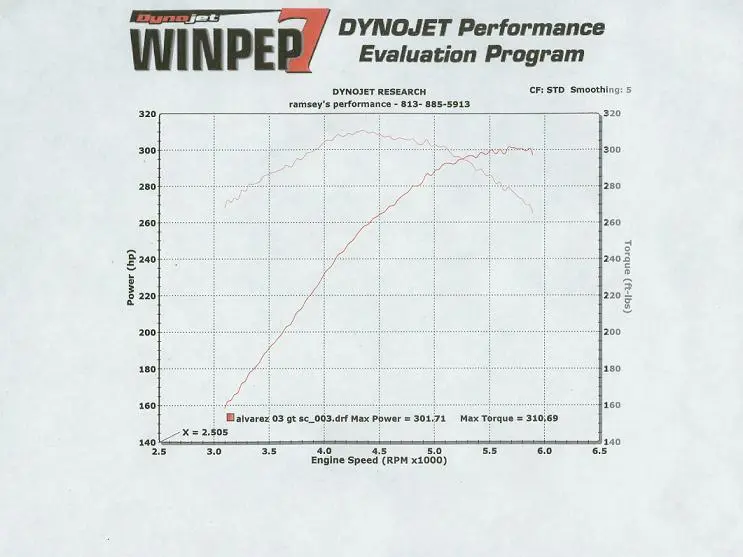

I posted before with my dyno run chart. This thread also has my A/F chart.
My car is a 2003GT 2V 4.6. Aside of the Vortech SQ, Superchip, weld in Flows and Triax, it's stock. I have NGK tr6's gapped at .035 and run only 93 Octane.

I emailed these charts to Mike Ancheta at Vortech, but haven't gained any advice yet, aside of they think it's the tune and that the A/F should be more of a straight line throughout the run, instead of squigly. Does that sound right?
Ramsey's Perfromance in Tampa did my tune. They're standing by it. They mention that once I get the aftercooler, I'll see more HP. I'll get it, just not now. I want THIS issue cleaned up before I invest anymore money into the shop, OR Vortech. Ramsey's is willing to take a little more timing out of the tune if detonation continues.
Vortech claims that on a stock 4.6L 2v, this system offers a 104 HP increase.
If my gt put down 225-230 rwhp STOCK, shouldn't I see 325-330 STOCK, with the blower ONLY???

wow, that is weird. i got a MPH mongoose kit with a vortech sq . i dont have an intercooler, but i do have an o/r x-pipe. with this set up i put down 368rwhp, and thats with california's 91 octane. Tim Barths tunes are supoosed to be right on the money, although my a/f is kinda rich, it is safe. are you using an SCT chip? your car should be putting down more, at least 350 rwhp.
Do you even know how much boost you are running? Like I said before you can't just slap a blower on a stock engine and expect it to put down 400hp. I guarantee you have the stock pullie and are running 5psi. If your worried about your numbers you need a smaller pullie and you need some actual supporting mods.
I would like to see a data log... Something isn't right.. You should pick up way more than that. Did he use the stock 3.60 pulley, upgrade injectors, fuel pump, MAF, Power pipe? Or just the supercharger and nothing else?

I noticed in your first graph you have a column of data labeled "AUX". Is this boost? If so, you are only getting 5 lbs max. If not, what is this "AUX" reading?
Deadlurker: What specifically do you see wrong with the a/f? Is it that spikey area?
the AUX is probably MAF voltage. although it looks low.
Deadlurker is right, your A/F ratio is rich especially considering that those numbers are after the cats. you're probably running in the 10.5-10.8 A/F ratio range. leaning that out closer to 12:1 will pick up a nice chunk of power. i'd guess 25-35rwhp. also, how much timing is the car running?
It is my Mass Air Flow sensor voltage.... topping out! :(

1) if they are real tuners ,they should know that you dont tune a/f AFTER the cats.
2) the stock maf is good to around 425 or so rwhp.So pegging the maf is NOT the problem.They are trying to sell you something.
2) the a/f is wrong because of after the cat tuning.If the car is pinging you WILL blow it up.Dont go into boost till it is fixed.Ping on a blower car esp if you hear it is a VERY BAD thing.

I don't like that idea. Get a new MAF and retune it. Don't be cheap now or you'll be dealing with an expensive bill later on.
The almost 10.1 a/f at redline is definitely killing your power potential.
