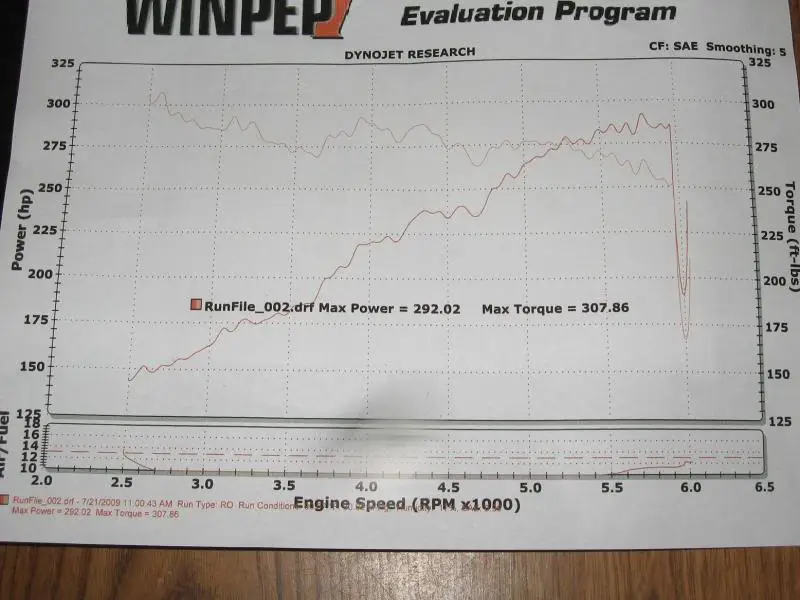

292 RWHP & 308 RWTQ was the best pull it made, but the air fuel was in the low 10's for almost all of the pull, the graph is very choppy. Car could use some tuning for sure. There is probably an easy 20-30 rwhp in tuning.
Needless to say, Im disappointed, but I kind of expected it, and there is alot more to be had with tuning, bigger cai, tb, pulley, meth. The car pulls alot harder at night, so Im sure will break 300 rwhp in cooler air, but as it sits,
Im disappointed, but looking at the tune, there is obviously more to be had. Peak torque numbers arent high, but it's nice and flat, thats probably what makes the car feel peppy. Will post the graph in a bit.

Steve is still using Autologic stuff?
I know he has experience with the svo heads, I remember his car was the first in the 11's NA with them, but those numbers seem 15-20hp off of what I would have expected.
It was tuned in 2002. Previous owner says the car was low 12's or so air fuel back then (which is lean to me), made 320 rwhp with the wrong plugs (too short, didnt thread far enough into the SVO heads), and doesnt understand why it would be 10's now. My fuel pressure gauge started acting up when I blew a FPR the other night, so I may put a manual gauge on it to make sure something else isnt going on. Car runs fine though, so I doubt thats an issue, but who knows. I know it doesnt like the heat at all, it feels alotttttt stronger at night.
Agreed .. a tune will help with that final output but not bad for less than 6lbs of boost. Actually that's not too far off from others I know with the same combo. 15-25rwhp and trq off, isn't much. I know for me .... it's perfect as DD.
Look at the air fuel
