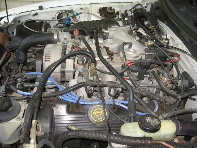

Im having a weird issue. Car usually makes 5-6 psi, well sometimes it will creep up top 7-8 even 9 psi. It seems to only do this after driving around for awhile, and when shifting really hard. The car almost kind of surges slightly on the shift, then the boost gauge starts creeping up. If I just roll into it in third and start going, it doesnt get that high. It's an electric digital Nordskog gauge.
I wonder if it's something with the bypass valve?
You can see where the boost gauge is plumbed on top of the intake near the EGR.
