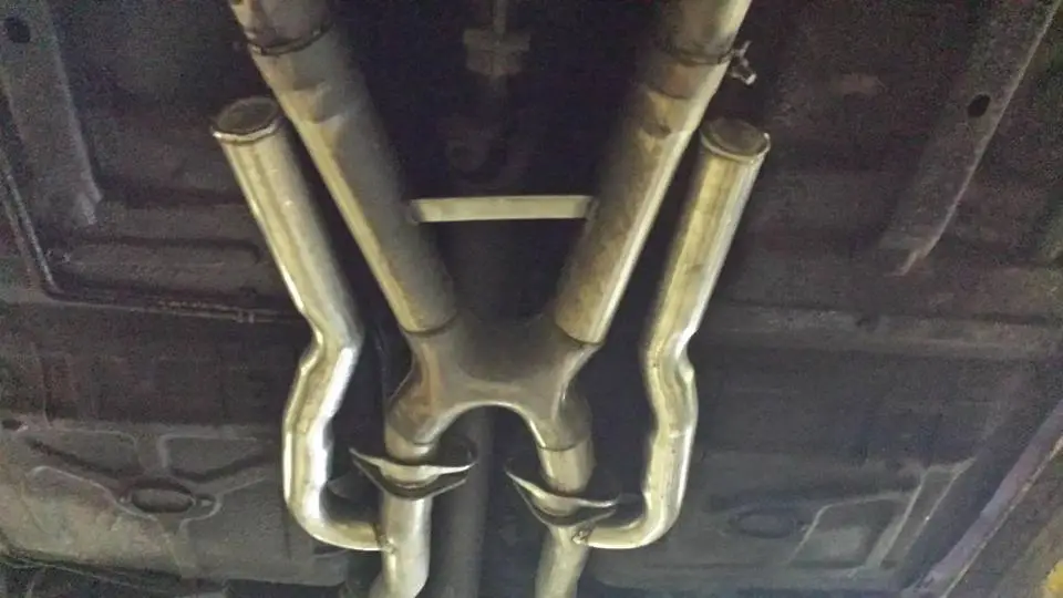

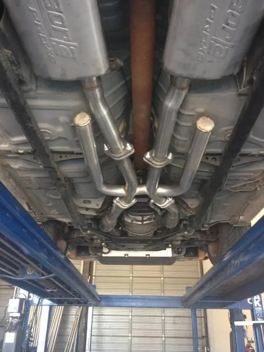

LOL...your biggest thing is, you don't want drone, but a barely audible rattle that last for 5 seconds will drive you so nuts you'd rather live with the drone. Check. Got it. Your only real fail-proof solution to drone is pick whatever mufflers you want and insall 1/4-wave tubes, they're magical. I would have, but I don't have room on this car thanks to my suspension. VT's got the nod...and guess what? No drone. That's their entire reason for being.

You can go through $1000 worth of different mufflers that will ALL drone, and end up pissed off and broke, or you can do 1/4 wave tubes and kill it no matter what mufflers you run. Super Turbos? Drone. Ultra flows? Drone. Quiet Flows? Drone. Magnaflows? Drone. Borlas? Drone. Been there, done that, with every single one of them.
