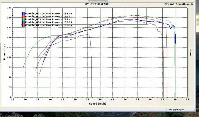

Disappointment at the DYNO.
I ran my best at 205hp and 283 torque. The guy who tuned said I need new spark plugs. Mine are still original. He said that he had to pull too much timing to get it to not detonate. I was commended for my efforts by everyone who worked there. The owner of the shop said he has been telling people for 15 years that the eaton m-90 will NOT go on this car. I proved him wrong. I also noticed after the dyno runs that the throttle cable extension I made had slipped and the car was not getting the throttlebody open all the way. Needless to say I am very disappointed.

ok, I think something was seriously wrong there, its like your not even making boost at all???
with a few minor bolt-ons(no charger) my dyno run was 226hp/265tq, tq was a bit low, dunno why but most report more tq than that, with it close to stock.
What was your AFR and what did he have your total timing set at?
