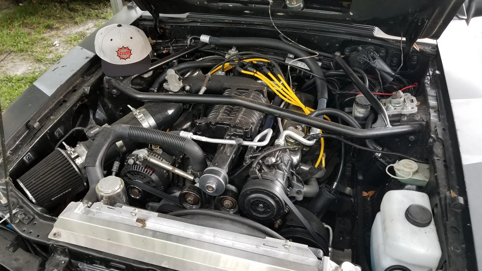

I did both a remote mount m90 and a m112 on top of the engine between the valve covers.... I actually still have most of the stuff for the m90 project.
Which would you recomend for some one who is a bit of a nood to all this? Because I found a m90 for sale for like $150 and just started thinking this could be a fun project

a single eaton m90 is too small on a stock v6 supercoupe
you will need 2 one on each valve cover and only then will you be in business. You'd be limited to about ~400rwhp though on an otherwise stock engine. Toss on a hci swap and you'd be in the ~585rwhp range.
with the one m90... over spun to the moon I made 10psi at 3k rpm with iron heads that netted me 400rwtq, by 5k i was down to 6psi and it made 330hp.
the m112 made 11-12 psi with a 7.21 lower and 2.8 upper pulleys at redline, 2k would make 8psi. I never took it to the dyno with that setup. Alex on corral made in the 700+ range with the same blower on a 363

Yeah that's what am afraid of the Fab work, not so much about the power as it is the looks and sound of it might give it a shot anyway worst case scenario Ill have a pro take over for me.
I'd happy with the 330hp all day I don't want to go too wild, its still gonna be my daily work car.
