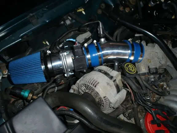

hope that helped... i got the same intake you're lookin at, i just chopped it isnt of doin a fenderwell... i believe i used whatever was stock... it was so long ago, i sorta forget lol
yeah you're gonna have to save the stock maf though and use it between the piping as the pictures above show, im not sure if that was your exact question but yeah.

Thanks for the help guys. I understand now. Just, from the pictures I didnt see any place to mount the existing MAF in there, so I was kinda wondering. Thanks again.

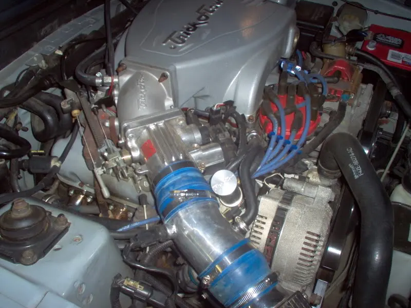

Thanks for the pic, it helps clear things up a little. Still not too clear on how the MAF mounts in there though. Hopefully it'll make a little more sense when the kit gets here.
It makes sense once you see it. The MAF is in the stock black air box, you take it out, and it bolts ontothe back pipe, and has the coupler holding it to the front pipe.
EDIT: Other way around.
Once you get it u will see.......there is a flange that has 4 nuts and bolts that when you remove your MAF out of the stock air box you attach it to the pipe...and then use the rubber couplers and clamps.......
