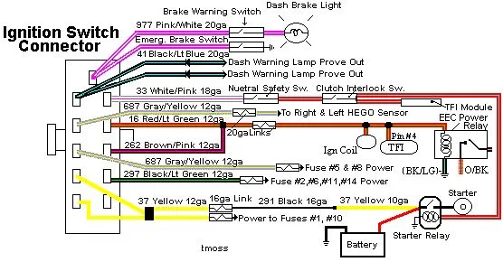

The ecu and cranking on a 1/4 turn are not related at all.. These cars do not need a computer installed to produce spark. You have a wiring problem.
Can I ask what you mean by quarter turn? Assuming it's the ignition cylinder that you are referring to. Positions are accessory, stop/lock, run, and start. To go from the stop/lock position it is about a quarter of a turn or it could be that you are calling a quarter turn one position as it is one our of four possible positions thus a quarter. I am only going to this level of detail as the more detailed you are and the better terminology you use the more we can help.
My guess here is you are saying it was cranking when in the run position and not the start position. This to me means one of two things:
1) The ignition switch has an issue and internally it is allowing the white/pink wire to have 12V+ with the ignition in the run position
2) Somewhere in the wiring in-between the ignition switch to the inner fender starter solenoid the starter wire is being exposed to 12V+ but only in the key run position.
Is the car a manual trans or automatic? If its an automatic then there is a neutral safety switch and if it is a manual then there is a clutch safety switch. Either way that switch has to be closed (auto trans in neutral or clutch depressed in a manual car) for the car to start.
If the starter is engaging and quarter turn means the key is in the crank position then ignore all of the above. In this case with a stock ECU and no spark then my next move would be finding a known good distributor and swap them out to see if that solves the problem.

Computer has nothing to do with a no spark or cranking early situation. Its either the switch or the wiring. Watch this... No computer, it cranks it sparks... The ecu controls the timing of the spark, even if its bad the tfi will still generate a spark. I bought cars that ran with computers that where fuber before, they ran like dogs :poo: but, still able to fire if the base timing is right and most of the injectors are firing.
Something in the wiring or a failing part of the ignition switch system caused your issues with early cranking. The megasquirt if it fires with out the pip.. Either the timing map is off or the base timing is fubar would be my first guess the ecu swap should have no effect on it cranking early in the key cycle I'd suspect the ignition switch wiring or the fusible links off the the starter relay being damaged is the cause. but without probing wires your just guessing all depends on how you fixed the wiring from the fire. If its wired like stock its not the computers causing the problems you described.
