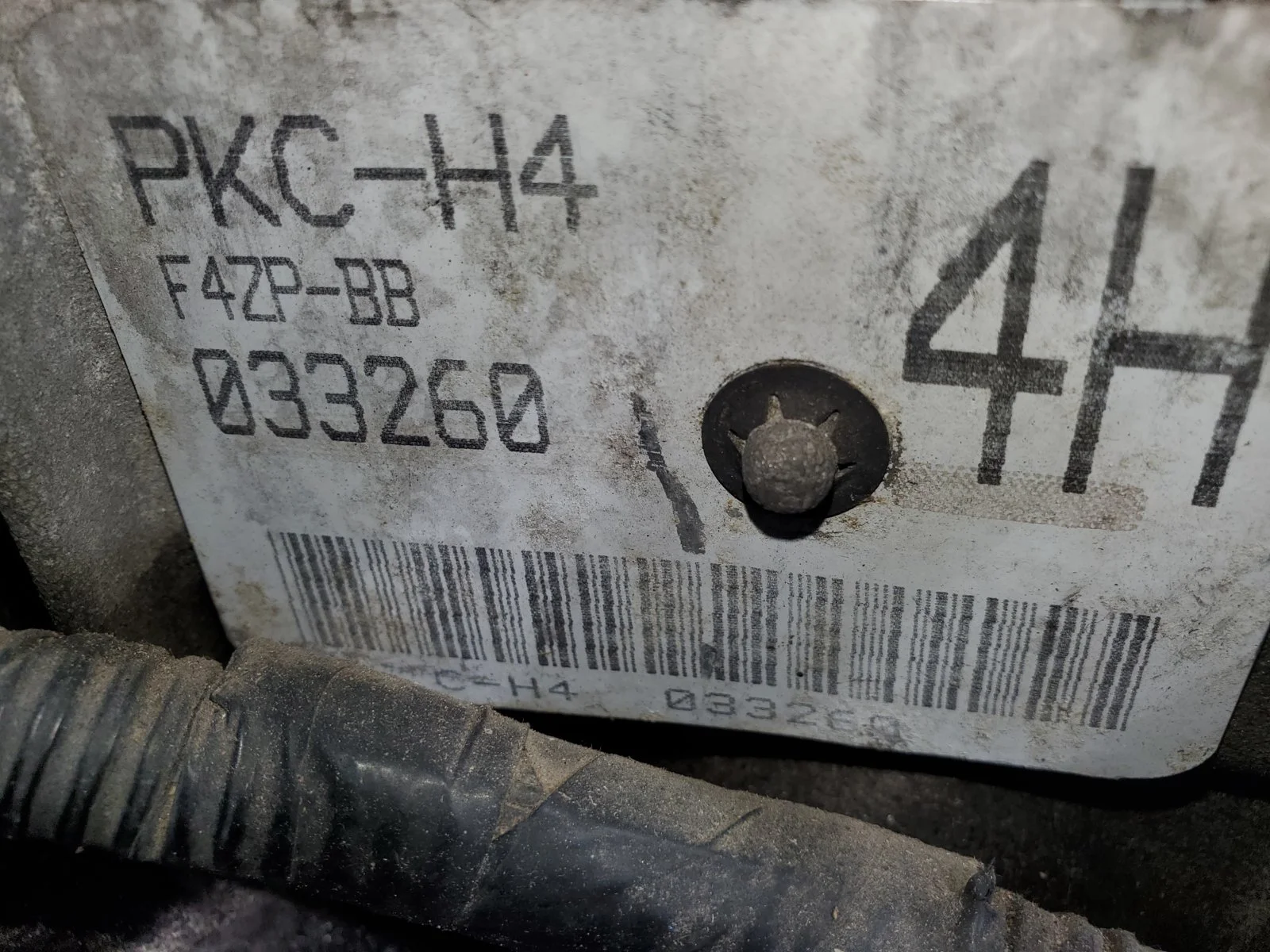

All i have is a tag on transmission . Is this enough to get one? All auto stores ask for a VIN
