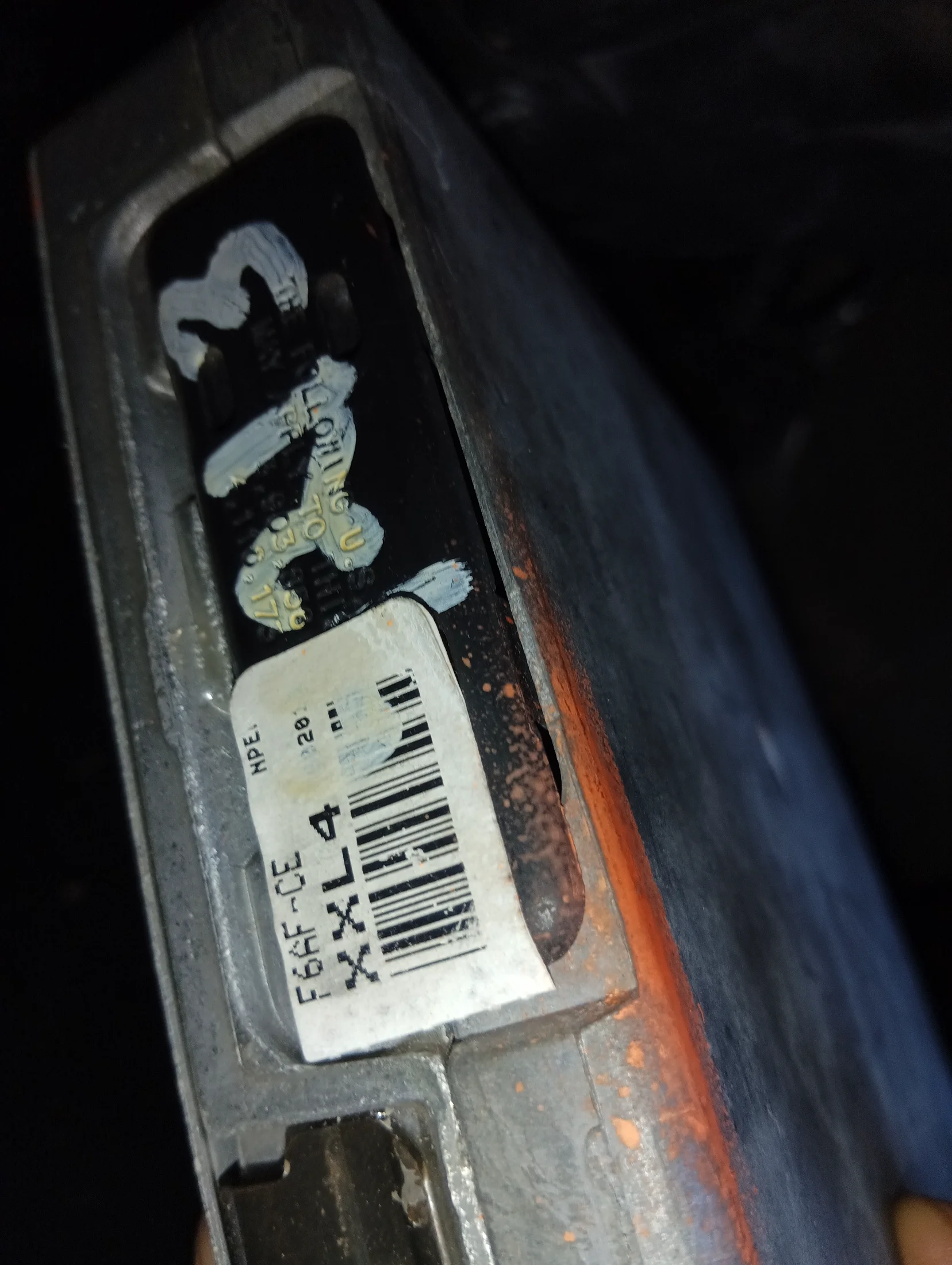

So I recently bought this 96 mustang 4.6l. the pats system went out of it, I figured Instead of buying a new module and getting it programmed I would swap out the ECU with either one with the pats deleted or a different ECU. I've been doing some research and some people have said a 96 Grand Marquis ecu would work, also some people said the p71 ECU out of a crown Vic police interceptor would work, and gain extra power. As long as the speedometer works, I'd be happy. Anyone have any thoughts that could help me out? It is a manual and the ECU is eec-v hookup.
No one had anything to put forth so I bought an ECU out of a 96 crown Vic police interceptor. It plugs in and runs just fine. Everything works, speedometer, headlights, etc.. they're cheaper than a mustang ecu and as far as I can tell there isn't a decrease in power, if anything there should be an increase with the police tune. So I guess I'll document it since I was never able to find any information. An older PI ECU works in the older mustangs, try to match the year.

I believe only 96-2000 interceptors had no pats. There's a few catch codes I've been told but I know for sure that XXL4 is a police interceptor code. VPX3 is one of the common civilian catch codes. Also at the end of your code, the long one, there will be a two letter code. CE or CF is the police interceptors as far as I am aware. Ones that that with A like AE or AF are civilian. If you look at a crown Vic forum you can get a lot more information than what I know.
