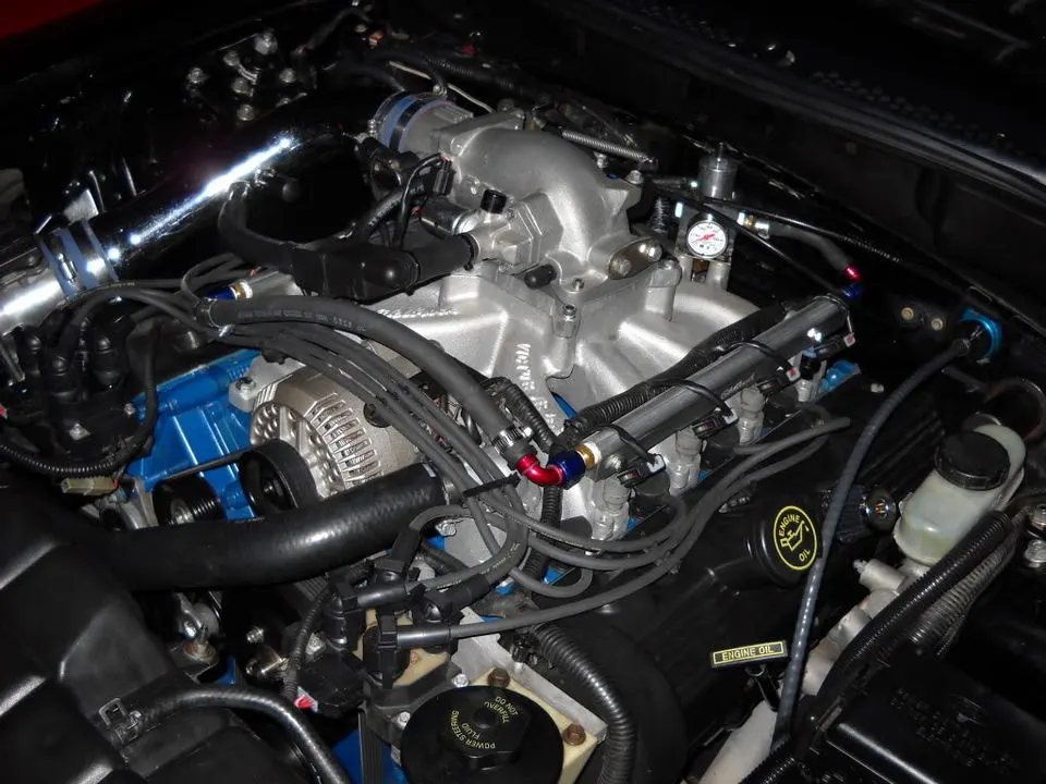

mmr makes a full kit to attatch aftermarket rail to the stock lines,
to do the swap i needed
the intake
adapter plate(i made mine my self)
edelbrock fuel rails
MMR regulator, (i have a return system)
autometer fuel pressure gauge
2 fitting to connect the stock lines to -8 feed and -6/-4 return
3 AN fittings (2) -8 (1)-6
-8, -6, and -4 high pressure fuel line
-8 from rail to rail
-6 to the regulator
-4 from regualtor to stock return line

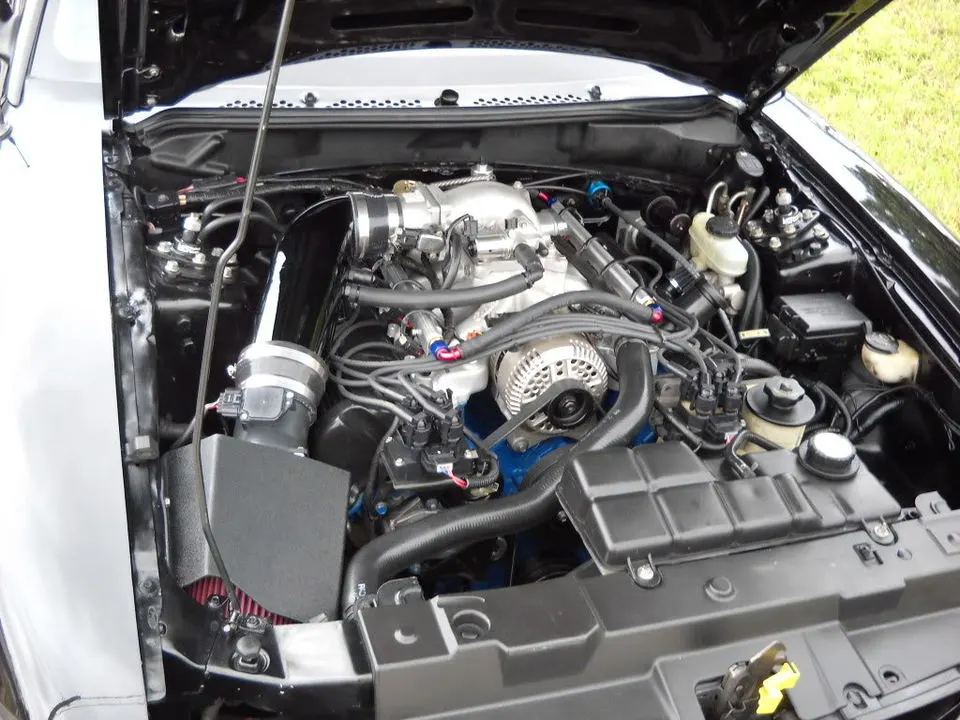

now with the JLT and 90mm MAF
Thats one sick looking 2v:hail2:
