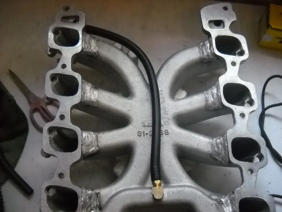

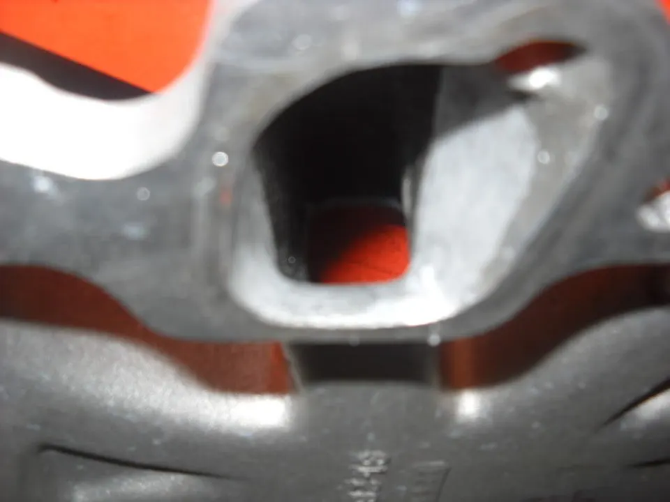

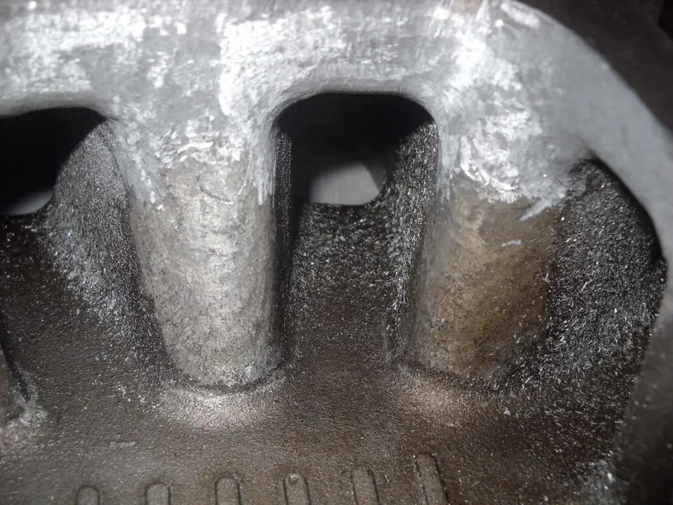

the edelbrock is a very nice intake, but since its made to fit under a stock hood its not designed the best, very sharp curves in the ports ect. so i had some welding done to it, and im working on the porting now, along with the coolant mod (pretty much the same thing that 4v guys do)
before welding and porting

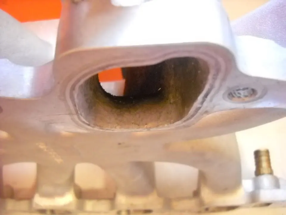

after

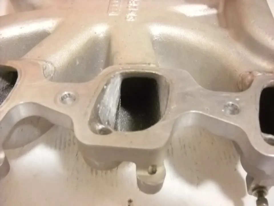

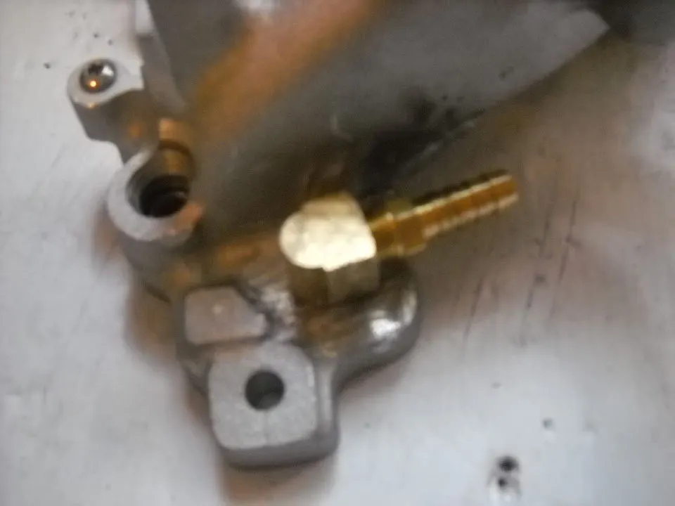

smothed out, drilled and tapped for the coolant mod(driver side rear)
coolant mod and welded intake ports

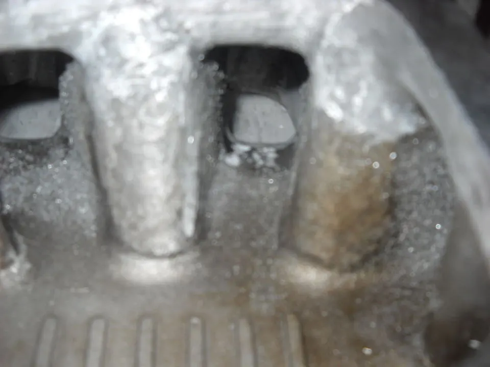

before
after, i also raised the top of the port.
im still no where near done

Holy cow, not sure if it is just the combination of the angle of the pics and port work, but that intake looks like you ported the crap out of it. Any worries about flow velocity?
Good luck, when are you hitting the track again?
yea i did alot of port work, but it really needed it! since these were designed for a carburator they dont have alot of volicilty, which fuel injected cars need.
ill be back at the track in about a month, the weather is just starting to cool down here in flroida
