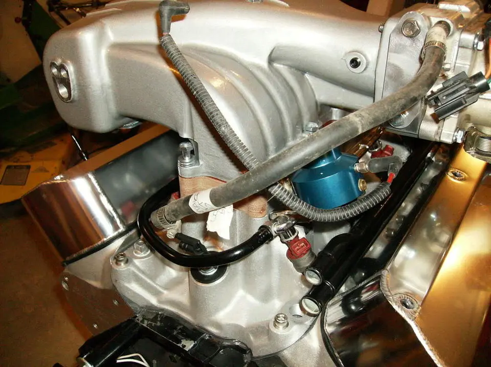

I haven't run the lines yet in this photo but:
I blocked the bottom ones by the removeable cover/plate underneath with the supplied pipe plugs. The little black one on the right of the photo after the egr plate I took out and put a vaccuum fitting for my fuel regulator. The very left side where the three holes are: I used the right small one for a fitting for my pvc, the small one to the left and big one underneath for the hose coming from my vaccuum tree. So far so good..............the instructions aren't very in-depth and lack pictures..........:notnice:
Nice intake overall however I wished i waited for the powdercoated black one to have come out first......and on top of that I sold my polished FMS Gt-40 tubular for this one :eek:
