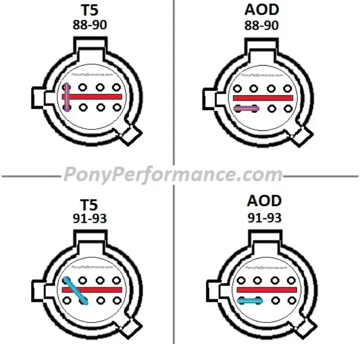

First....determine if the car was originally a stick or auto
Second....send that computer in to get repaired, most here use the ECUExhange
Third....check and adjust the 02 pins for the computer
An inexperienced opinion based on hang'n here, the pins on the 02 need to match the computer before you turn the key on, some have gone for a while and never had a problem, sometimes it take many miles to effect the computer and it eventually will.
a computer that does not communicate with a scanner, void of human error, has issues, think about it, how many 30-35 year old desktop or laptop computers are in use today?

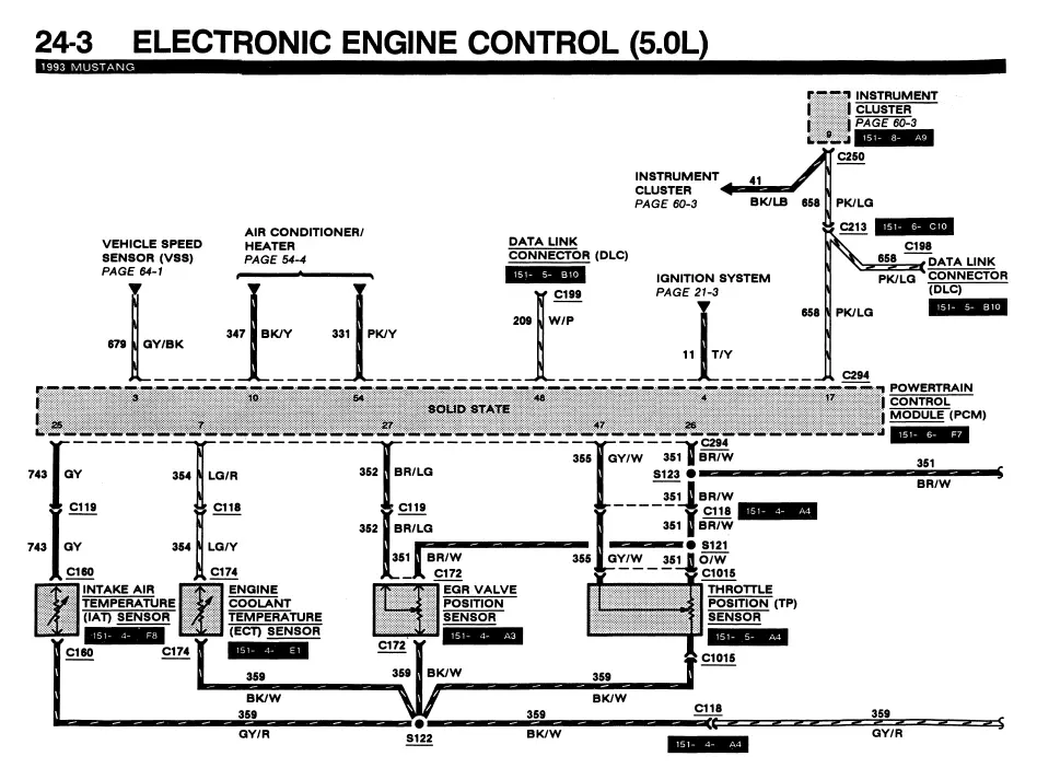

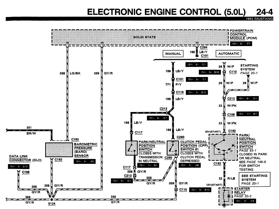

Not sure what you mean here. ECT, ACT, EGR PV, TPS, BP sensor all share a common sensor ground. Pin 46 from wire 349 That's why when pin 46 fries, the engine doesn't run well, if at all since it takes out a lot of sensors.
As for O2 sensor harness jumper, for a 1993 with a manual trans ECU ( i assume it's a stick) it should be pinned same as bottom left

Two pigtails meaning two connectors. Of course one connector is plugged into the sensor and then there's another connector for that component that could also be used coming out of the main wiring harness. Also when looking up some parts there are two options for same vehicle/engine.

A9P would be the auto ECU, so actually the pinout for the o2 harness jumper would need to match the bottom right position in the above diagram
If i'm not mistaken he has a A9P but a manual conversion.
