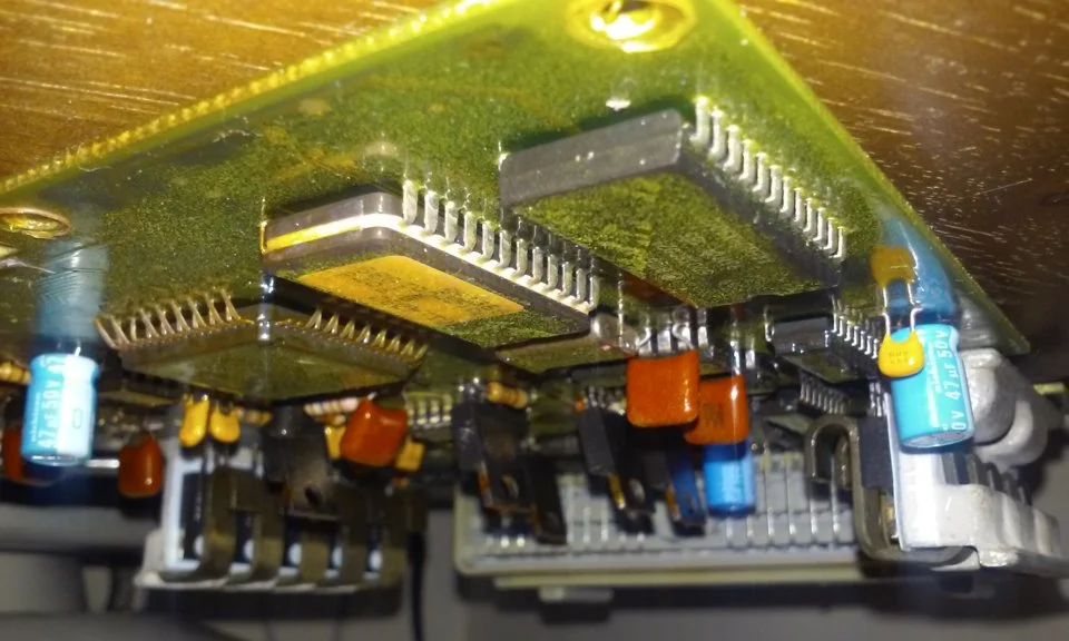

I have no continuity between pins 46 & 40/60 on eec connector, so I pulled the eec to inspect. After inspecting both sides of the circuit board, I saw no obviously fried circuit to go ahead and jumper (as has been the case for others). The only obvious issue was a leaking capacitor, so i will replace it along with the other two while I'm at it.
Could the bad capacitor be the culprit for my pin 46 issue? I will test after replacing caps, but if issue persists, how should I go about identifying where the issue actually lies? Can I simply jumper post 46 to post 60 where they lead into the eec, that is, the posts that connect pins to circuit board?
The only other issue I saw is that one edge of the circuit board appears a bit oxidized (rust colored)? Is this a problem? Something I should try to clean up?
Finally, I noticed that the circuit board is covered with an insulating film, which I assume would have to be removed in the case of adding surface jumpers. Is that something that needs to be replaced afterwards, and if so, do I need a special product, or will a general waterproof epoxy spray/adhesive/clear plastidip do the trick?

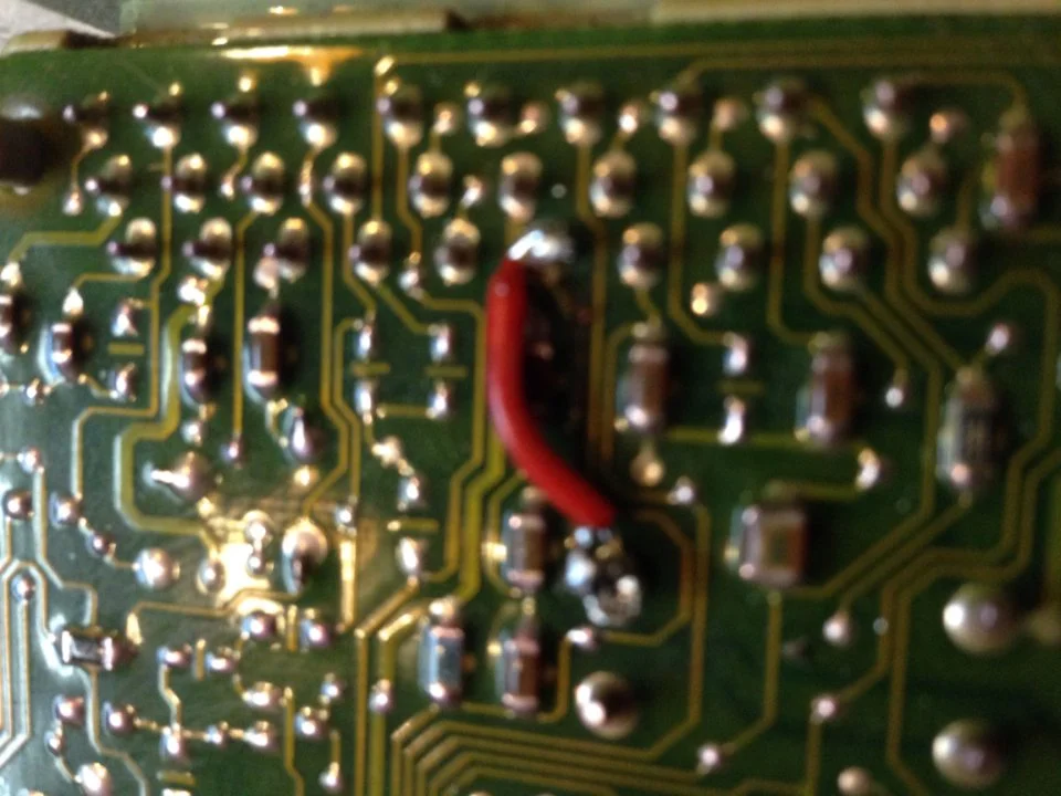

I used a bit of alcohol to clean mine befor soldering. And then coated it with nothing. I believe the colored stuff your talking about is the coating they use. It's kind of tacky feeling too right?
Here is mine.

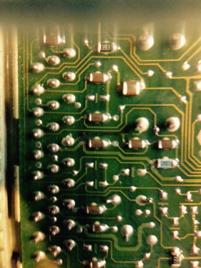

Here is my bad one before the fix. You can barely see the burnt trace.
You see the 3 little brown things going up and down. It's the dark spot between the bottom one and the second of 3. Hope this makes sense.

I don't really know what the caps are for but definitely replace all if your in there. When I looked for caps I found you had to buy a minimum order of 100. Coarse it was only a few bucks. I have another a9l with 2 bad caps I need to fix someday.
Thanks for your reply! I found two of the caps at Radio Sh** and ordered the other one on Amazon for a few $. Prob should have just ordered em bulk..
I do see the burnt trace between brown things 1 & 2 (official tech terminology.. Haha). I'll have to take a close look at my board this evening..

No prob, Bob. Welp, i reexamined the pcb when i got home, and it looks like the burnt trace between brown things 1&2 may be the culprit. It isn't obvious but it's there. Thanks for posting that pic!:flag:

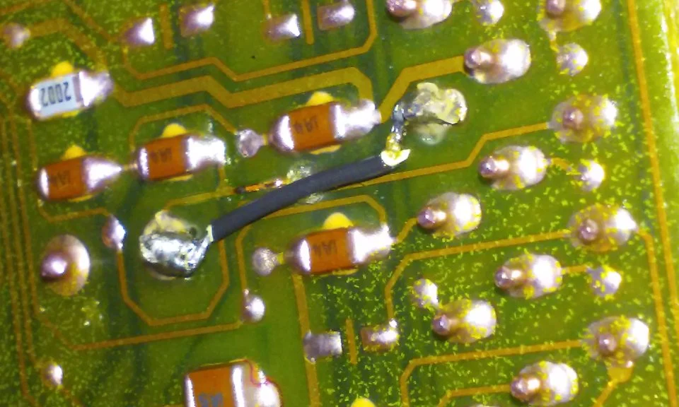

Thread update:
I got the digikey capacitors installed, and I jumpered the burnt trace (pics attached).
The jumper works as pin 46 now has continuity with 40 & 60. Thanks for the replies, jrichker and bob :nice:

Hey gang,
Thanks!
How did I get it solder on mine won’t stick
The PC board is often coated with a sealer/resin that you need to dissolve the get solder to stick. Acetone and a small bristle brush are the best tools to clean the board prior to soldering. Prior to soldering, clean the solder area with Isopropyl alcohol (rubbing alcohol).
If you don't have good experience with replacing components on PC boards, a TV or electronic repair shop might be the best choice to have the capacitors replaced.
