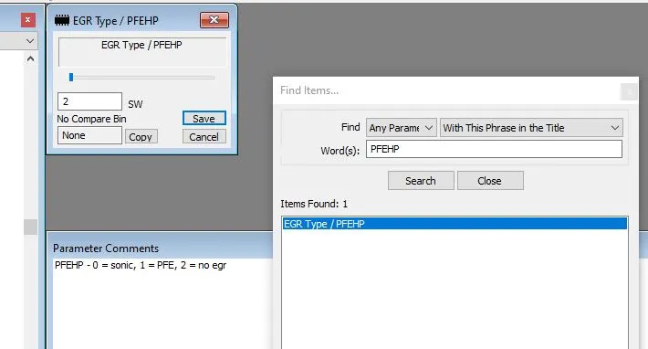

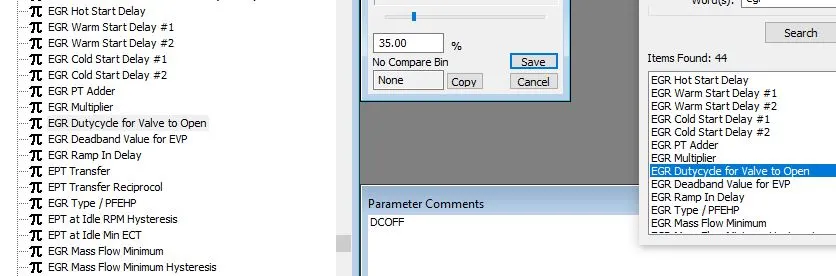

@FastDriver I'm just now looking in the GUFX related file/s and haven't yet gone through and identified the "switch" per say. I'm looking for the 0 or 1 value in the parameters.

@FastDriver This might be it.
FastDriver

  • Jun 28, 2025
  • #57
There ya go. Set that to 2. I just looked in my own tune and it's disabled.
