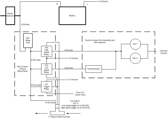

I run the Contour fans just like they do in the Contours. Both fans on for low and both on for high. I have a fan control switch basically the same as you are listing. Here is how I did it (and done on Contours - except the relays are trigger by ECU with Contour).
I detailed my install here...
Electrical - Contour Fan Install with OEM controller
So first off, this may have been done before but my install is a bit different than all I have read in the past. If nothing else it is a different way to hook up the system. I used as much of the Contour electrical system as I could and then simply connected my controller. Oh ya, this is a...
www.stangnet.com
I have been running this way for over 4 years now with no issues.

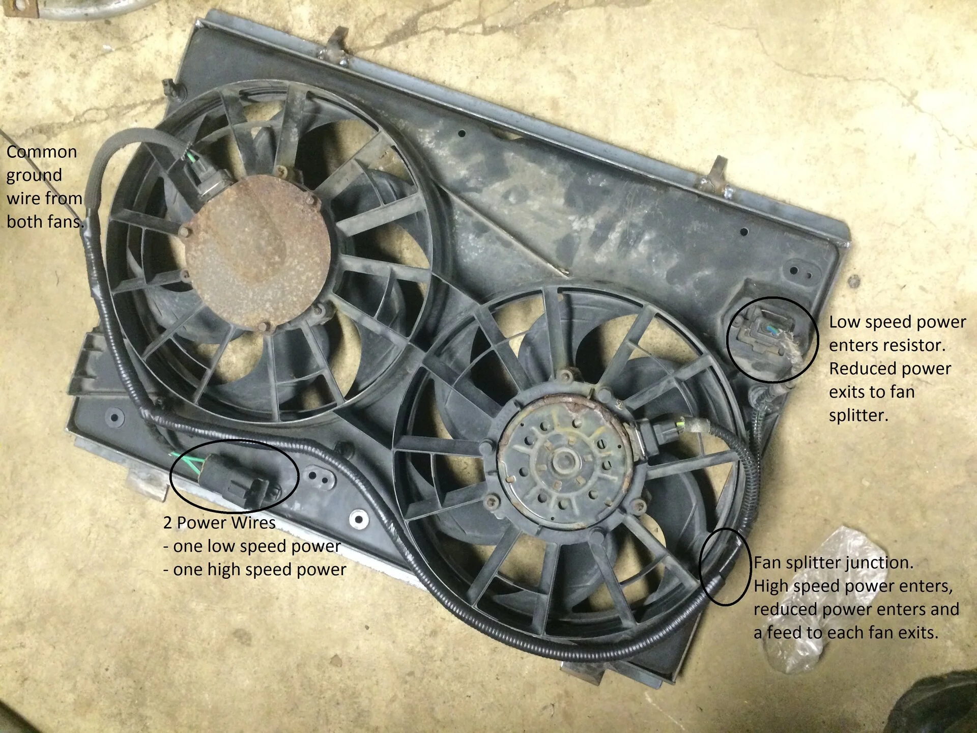

This is how the factory wiring harness is connected to fans and what feeds are...

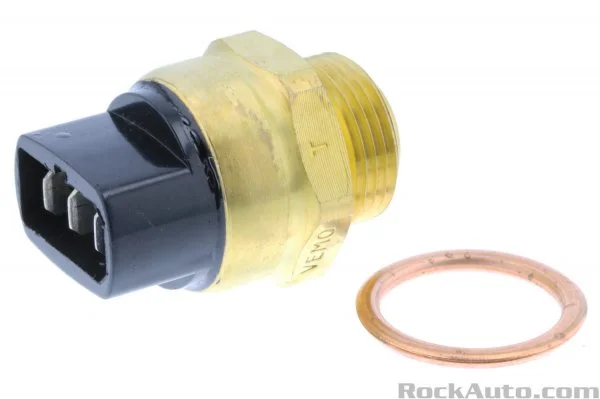

I used a sensor/switch from a 99-01 Audi/VW 1.8L Turbo. Can find them in Beetles, Golf, Jetta, A4 and others.
Some have used a sensor from a BMW (not sure of year).
I pulled the sensor and pigtail from the wreckers and have used that. It is a large thread though. Off the top of my head it is M22x1.5 i believe. I used an Axle nut from a Contour and welded it to a 4" piece of 1-1/2 pipe and installed in lower rad hose.

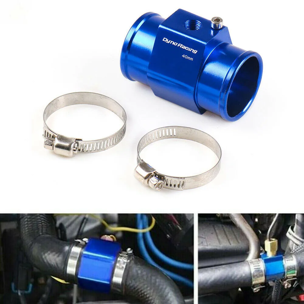

If looking for a way to install low temp sensor in lower rad hose, try one of these off eBay...
If you were planning on installing in t-stat due to size, the hole provided here may be the correct size already. Get the 40mm version. Then simply cut the lower rad hose and install with the clamps. In my opinion this is the absolute best location for a temp sensor to control e-fans.

Depends on what one you had in mind already. The Audi one I used is dual range, low speed kicks on at 95 C, off at 82C (approx. 195/183). High speed comes on at 102C, off at 92C (approx 212/190). But to be honest, high has NEVER come on.
If you can mount the Toyota low speed sensor in the rad (or near it - lower rad hose), I would just put high speed on a toggle for back up (not worry about an automatic triggering).
