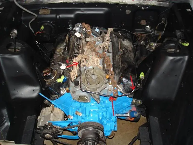

Just finishing up the EFI wiring and hiding some of the engine compartment wiring after repainting the engine bay.
What do you think? (ignore the red arrows)
granted I'm still young and low on experience with car restoration, but I think it turned out pretty good for my first time. This car will never be a show car, especially after looking at all front end sheet metal - it all needs to be replace, frame rails including.
