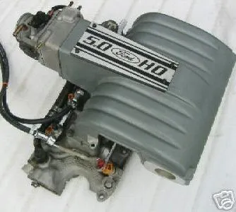

hey guys i jus purchased this for 195. you think it was worth it?
now i have like uhhh 40% of my EFI project complete. err..
Thats an OK deal if its all in good shape.. I cant see real clear but It looks to me like the hoses are clamped to the fuel rail... Thats a No-No!

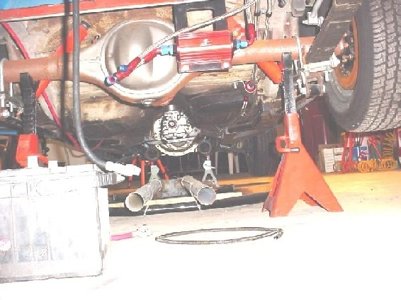

From an EFI conv on a 68 Coupe...
We ran new lines. Mounted the pump on a plate. Tank was baffeled. Works great!

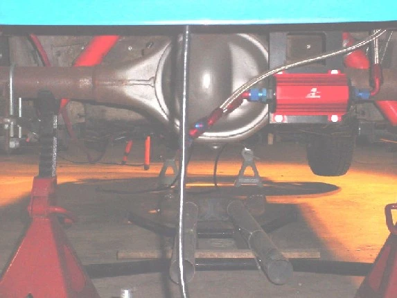

Thought I had a picture of the bottom of the tank. This one shows the fuel filter and the two lines running forward on the right. THe wiring was quite the project. I think the harness was Windsor-Fox. I modified nearly all of it...one wire at a time. We spent two summers just getting to the point where we could start the car up. The O2 sensors gave us a lot of trouble. If you can use shorty headers then try to go that route. The long tubes we installed I understand are now coming back out.
