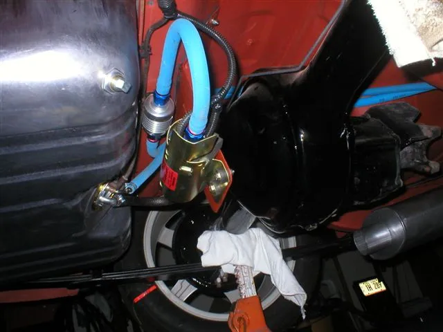

Blue is 24 lb injectors.. what kind of motor are you running it on? Ill bet my 331 is over 400HP at the flywheel and is perfectly happy with 24 lbs.. I dont run any LP/HP pump setup or an accumulator, just an external 155lph pump in an oem ford mount, never a hiccup from it. Heres a pic
Flow Rate lb/hr = (HP*BSFC)/(Number of Injectors*Max on time)
BSFC = .45-.55 unless you have specific numbers from a dyno
Max on time = .8 unless you enjoy overdriving the injector coils.
For TT670's 400 est hp = 400*.5/(8*.8) = 31.25lb/hr (running the injectors at 100% works out to 24lb)
So as long as you aren't running around at WOT all the time it'll probably be ok. Seems most mfg spec a max of 80% on time, 19lb injectors are just about perfect for 200-210 hp. I'm running probably 270 or so, and at specs out to 21 lb, so next size up would be 24, I was just looking for a cheap source, even if it meant 30lb..
