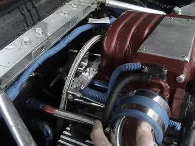

I finally got my '67 up and running with a Fox harness, computer, fuel rail, intake , etc.
I'm running a Victor EFI intake, no EGR spacer... problem I'm having is I haven't ahd much luck fabing up a throttle cable bracket as anything that puts the cable in a proper location will hit the pressure regulator. I can't use an EGR spacer because it'll hit my tall valve covers...
I really don't want to run the TB upside down, what have the rest of you guys done?
I've put in the export brace and such since, but here's a shot of what it looks like...

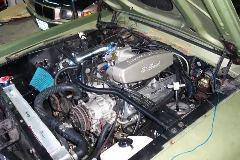

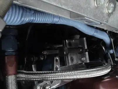

Don't know if it will work on a 67 or not, but here is how I handled the problem on my 66. Using an original 6 cylinder throttle setup, I added a heim joint and aluminum tubing. I connected this to the throttle plate on the throttle body. I am running an AOD trans, that's why you see the homemade bell crank setup. If you are interested and the pics don't help, let me know.
Thanks
