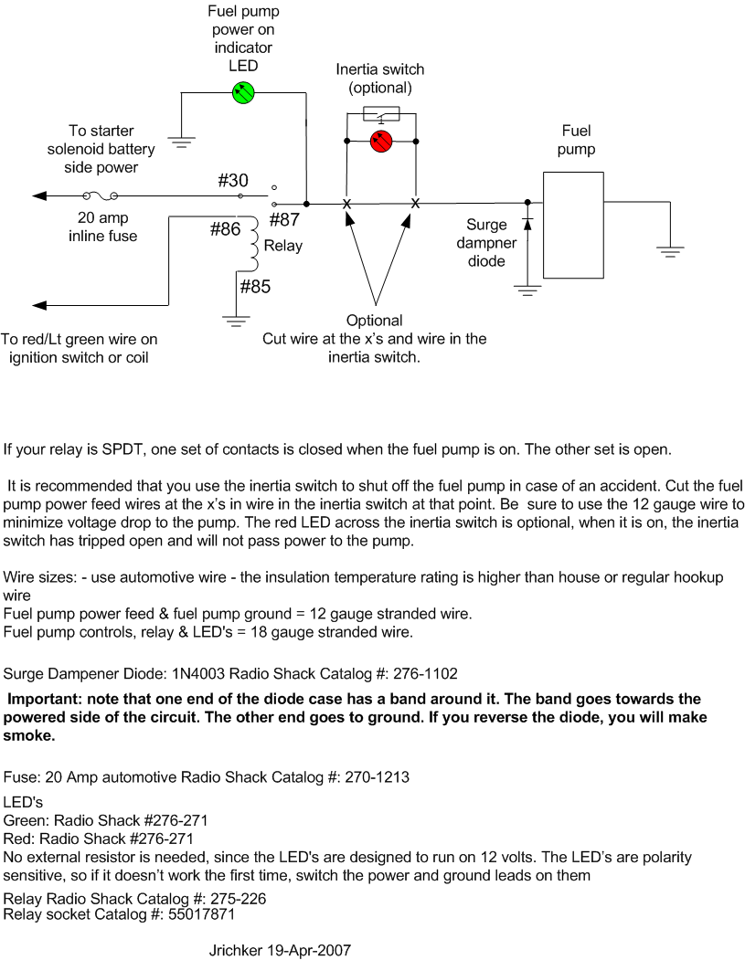

Hey guys!
so I have an 89 foxI bought recently. The owner went from efi to carb. When doing so he spliced his MSD setup into the engine efi harness rather than running all new wiring
I’m in the process of eliminating that harness. That being said, somewhere in there mix, the in tank fuel pump is no longer working. Since I’m trying to remove as much of the efi as possible, is my best bet to wire my own harness from the key to a relay and on to the pump? Or try to keep that portion of the efi harness and figure out what wire is what?
I’m leaning towards eliminating it and running all new wiring to the pump just to keep the engine bay clean
any insight?

EFI to carb swaps
Revised 10 Aug 2017 to add comment about using an in-tank fuel pump from an 85 5.0 Mustang
A word of warning on EFI to carb swaps: don’t expect to pass emissions in any state that does comprehensive smog inspections, because it won’t happen. Some states will not title or issue license plates to cars that have been converted from EFI to carb. Be aware that you are violating several Federal laws concerning the removal of pollution control equipment. If you operate the vehicle on public highways and get caught by state or federal law enforcement (doubtful, but possible) you could be subject to fines and imprisonment. You won't get any more power from a carb than you will from a properly maintained and tuned EFI system.

1. Do not use an EFI in tank fuel pump with a carb. You will never get the pressure/flow regulated properly. If the add on pressure regulator fails, you will flood the engine with gas and wash all the oil off the cylinder walls. That will cost you big time $$$. Either go full EFI or use a tank/fuel pump/fuel lines out of an 85 or earlier Stang. The in tank electric fuel pump from an 85 5.0 Stang can be used since it is only 10 PSI and not 40PSI+ output pressure that an EFI pump delivers.. Fabricating your own setup is possible but there are some snags to overcome.
2. Do not attempt to leave the EFI computer in place in an attempt to control either the electric fuel pump or ignition. Doing so qualifies you for the “Road Kill Mechanics Award”.
3. If you try to use your current tank, you will need to pull the fuel pump out and fabricate a pickup tube & strainer sock to replace the fuel pump. Or you can have a sump fabricated and welded onto you existing tank. Many welding shops will not weld fuel tanks because of the dangers involved if the tank isn't purged properly.
4. You will need an external electric fuel pump unless you change the timing cover for one with the mechanical fuel pump mount on it. The external pump will have to be mounted below the bottom of the tank to get the siphon effect needed to keep the pump fed sufficiently. Rip all the EFI wiring out, and the computer controlled fuel pump won't work. You will need to add a relay & switch and wire in the existing inertia switch for an external low pressure electric fuel pump. Do not try to wire the fuel pump without the relay. The 15-20 amps the pump pulls will overload the circuit. This will take power away from other items on the same circuit or cause the fuse or fuse link to blow.
5.
6. You will need to run some new fuel feed lines or braided hose. The 3/8" aluminum tubing works well, but you will need a flaring tool and bending springs to fabricate the lines. Braided hose is easy to run and route, but is much more expensive. It is about $3.50-$4.00 a foot plus the end fittings, which are $3-$4 each. Fabricating hose assembles can be difficult, but anyplace that makes hydraulic hoses can do it for you for an extra charge. See http://www.amazonhose.com for more information.

21. While you are at the electrical part, you'll need a Duraspark or similar ignition system. The 85 Mustang GT 5 speed has a suitable Duraspark distributor with a steel gear compatible with the roller camshaft. The EFI ignition depends on the EFI sensors to advance the spark. Rip out the TPS and MAP/Baro sensors and the computer will have no idea of the proper ignition timing for best performance. Running a fixed timing setting is only for test purposes or for a race track only car. Don't try it on the street: the results will not be nearly as good as a properly setup Duraspark or equal. Crane makes a really nice distributor for non-EFI applications. . See http://www.cranecams.com/index.php?show=browseParts&lvl=4&prt=127 for more information. Cost is about $400, which makes the 85 Mustang reman units look really appealing.
Duraspark II ignition diagram:
Diagram courtesy of /www.billwrigley.com
See http://webpages.charter.net/1bad6t/duraspark.html for more help.
Note the ballast resistor shown in the diagram: you’ll need that too
If you use a coil from a 78 or later Mustang, you don't need the ballast resistor. The stock 89 Ford/Mustang ignition coil does not need a ballast resistor
A simpler HEI ignition that uses the same distributor and fewer parts can be found here. This is an excellent resource, and I suggest that you add it to your Internet Favorites

32. The water temp and oil pressure signals feed from the sender to the main harness through the 10 pin EFI engine harness. To utilize these senders, you need to identify the wires and find a way to reconnect them to the main harness after the EFI engine harness is removed. You need a weatherproof quick connector to join the sender wiring to the main harness.
33. See the graphic for the 10 pin connector circuit layout.
34. The injector power pin is the VPWR pin in the black 10 pin connector.
35. You will need to construct a wiring harness from the ‘85 carb distributor to the Duraspark box if you go Duraspark, or other distributor to coil wiring.
36. The voltmeter picks up its signal from the switched voltage present on the instrument panel, so you don’t need to worry about that.
37. The fuel tank gauge is also independent of the computer wiring.
38. AutoZone wiring diagrams can be found if you are willing to dig through the self help repair section of their website. http://www.autozone.com/autozone/re...3835D6CFF5E3A5037BBBD332CF445FF.diyprod2-b2c3
