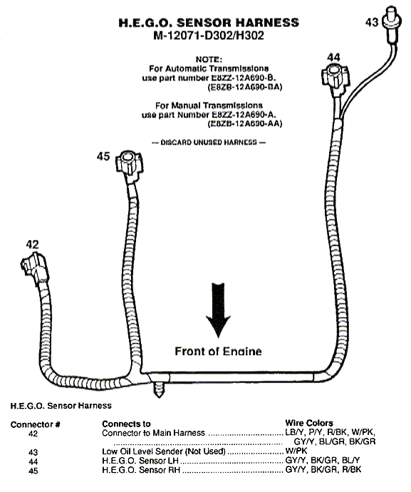

It is possible that the O2 sensor wiring harness is damaged or missing, seeing that some of the starter circuit wiring has been tampered with.
