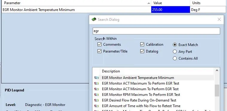

Cooler is better. Several years back, that was my initial common-sense thoughts on it all was how are warm exhaust gasses going to keep the incoming air charge cooler, especially here in the hot humid southeast US?

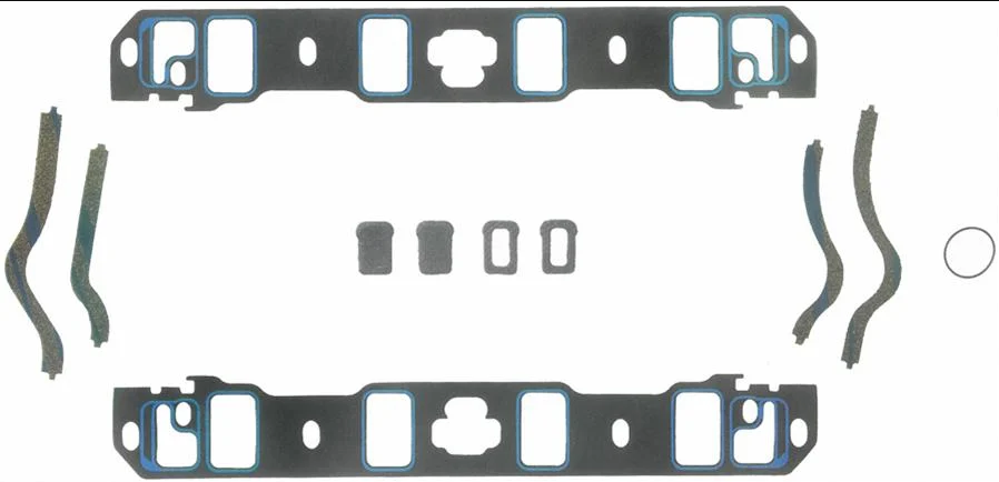

It is good that the little metal block offs come with the intake gaskets.
I haven't dug into EEC-4 Fox body pcm files to see if the EGR function can be switched off, but just two days ago while working with a 1999 EEC-V Ex 5.0 file, I found a setting that was more or less an ambient temperature of 32F (at a hair above freezing) must be met before the pcm will monitor the EGR.
I changed the temp to 255 (a good temp for smoking pork ribs). I don't think any of us will be driving around in 255F! The change is an experiment.
Friday during the first test of starting/running and turning off 8 times, no trouble codes were posted. Monday the pcm will be installed again and do about 80 miles of driving over a two-day period to see if DTCs post or not.
This spring I will be working with a 1989 Mustang 5.0/Auto Mustang ECM with EGR delete (EEC-4 OBD1). I'll add something later having to do with that.
No, I'm not a professional tuner. Just an old school guy wanting to use newer Ford 5.0s in antique Mustangs!
