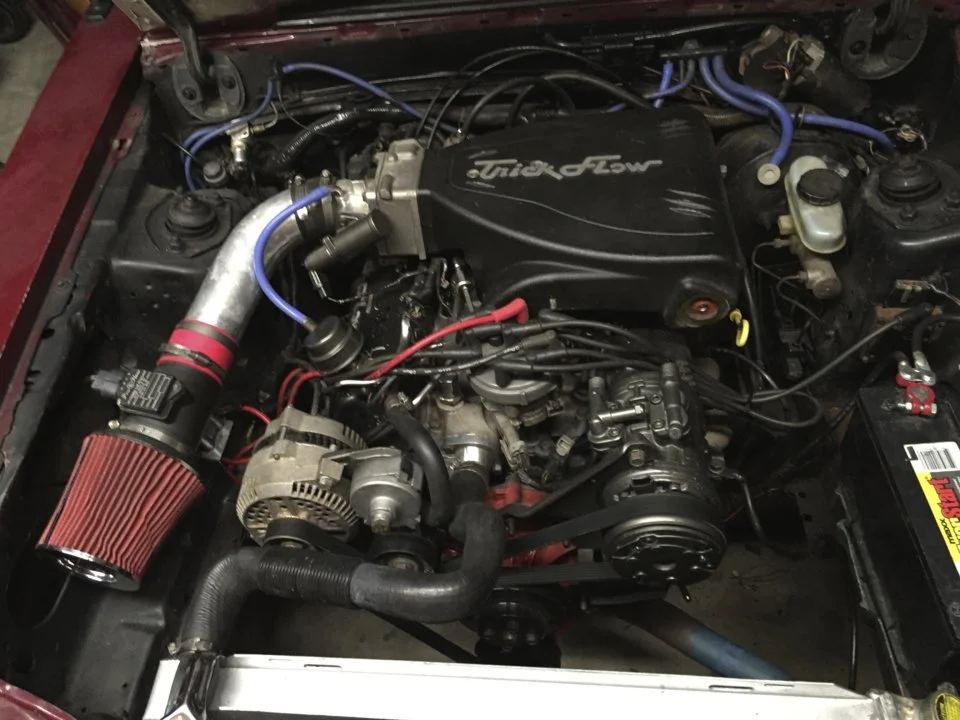

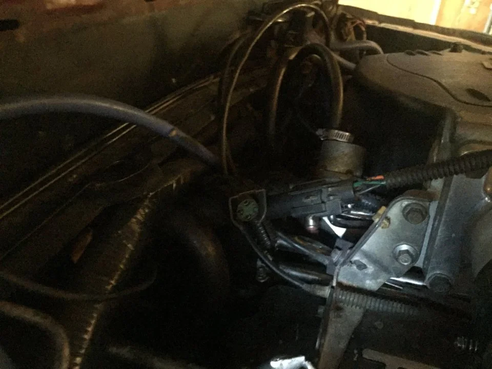

Ok so I got 88 gt and I have this plug coming off behind the throttle body, I believe its the Egr plug but not certain here are some pics. I keep getting code 85 so I figured that It was an Egr problem I was thinking about the eliminator but after reading around here some it looks like its kind of important. So what do I need to buy? The Egr valve and position sensor?? Could this be causing my problem with cold starts and staying idleing?

IT looks like your EGR was deleted altogether. Can you post a pic from the front of the engine?
But yes, that is your EGR plug.

I would either get the resistor that fools the car into thinking there is an egr there or install another one.

coupe of observations
1. get rid of that cone fiter and replace it with a fenderwell stock or aftermarket one. You are sucking in hot engine air
2. Cao ioff the fittings coming off your throttle body- you are sucking in unmetered air
If you don't plan on hooking up your a/c again, get an A/C delete and remove the compressor. You will remove about 20 lbs off the car
3. As long as you don't live in a cold area, you can use the EGR plug and the car will run fine.
4. looks like you don't have the charcoal cannister hooked up. I don't like that as you probably have the gas vent line tucked under the car venting raw gas fumes into the air. If you park the car overnight in a garage you are probably smelling the fumes. If you can find the cannister and solenoid in a junkyard, I'd put them back on.
5. get rid of those ugly blue hoses

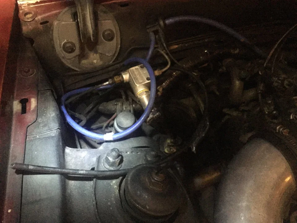

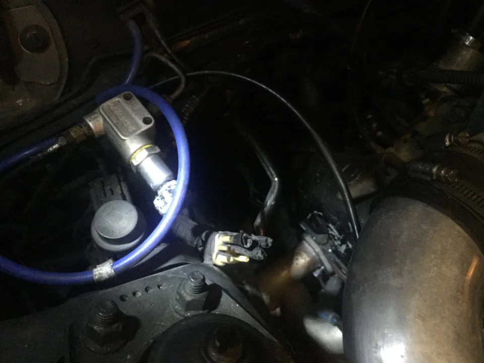

So just had time to look under there and this is what I found? Whats this black hose for it s cut off and just sitting in the engine bay it runs under into the fender? And this little vacuum tree is plugged 3 out of the 5 ports? What vacuum hoses go off of this?

Can't say what the black one is for sure, but it looks like perhaps fuel tank vent to the charcoal canister. Follow it down the rabbit hole?

Ok ill do that in a couple hours just got off work. Any ideas on the other one?

The small vacuum tree ran to emissions and dash vent control inside the car. I can't make sense out of how everything in that picture has been run. @jrichker has an excellent vacuum diagram.
