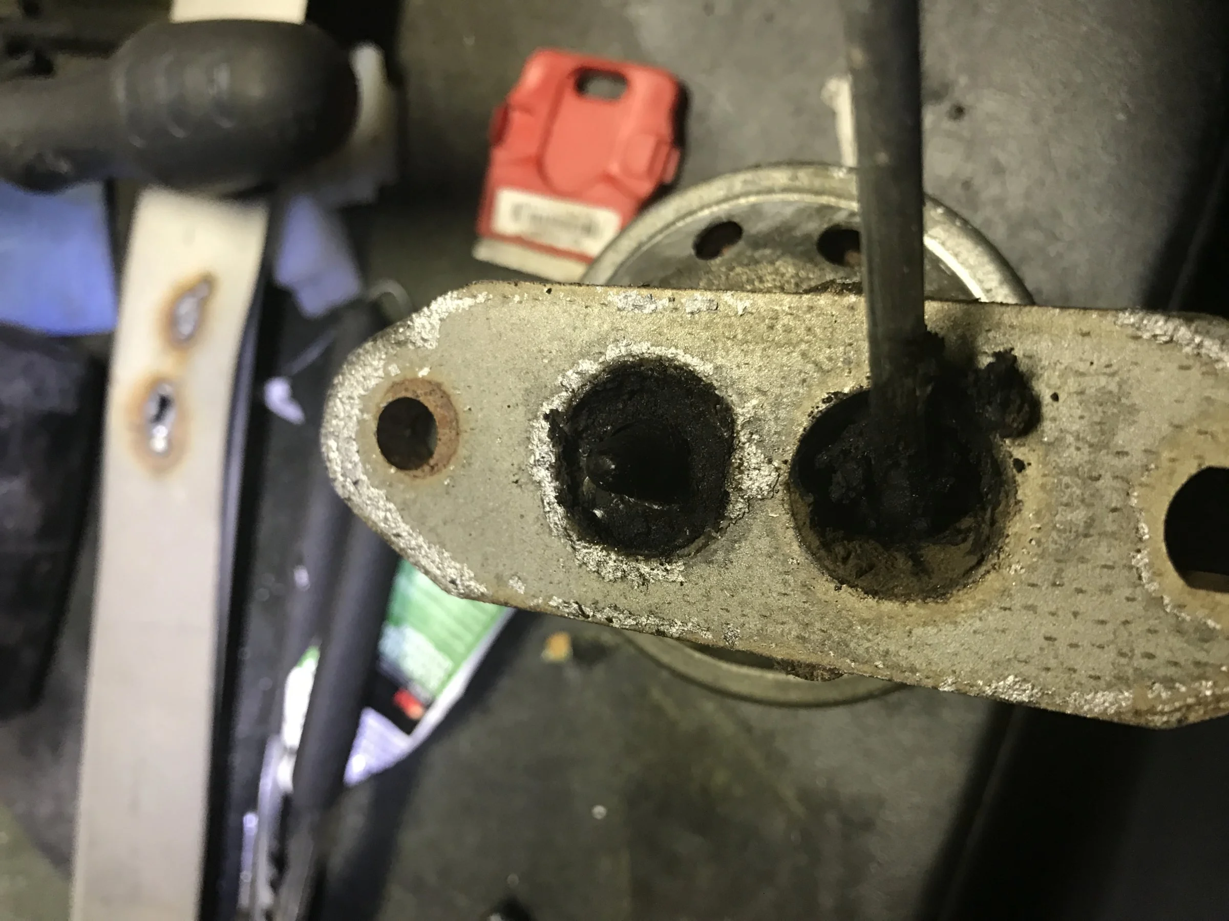

Ok. About to test the egr. Started by removing it. It's clogged full of carbon. I was able to pry the valve open and get it moving freely . Gonna try to de junk it. Hoping this is the issue.
When I got the car it didn't have a pcv screen, I believe it was driven that way a long time. Would that cause this gunk?

It would play a role in excess carbon

Woot!! No more code 33!!!
I filled it with carb cleaner and let it soak and took a brush to it and. Repeated 3 times.

Always a satisfying feeling when you fix something properly.

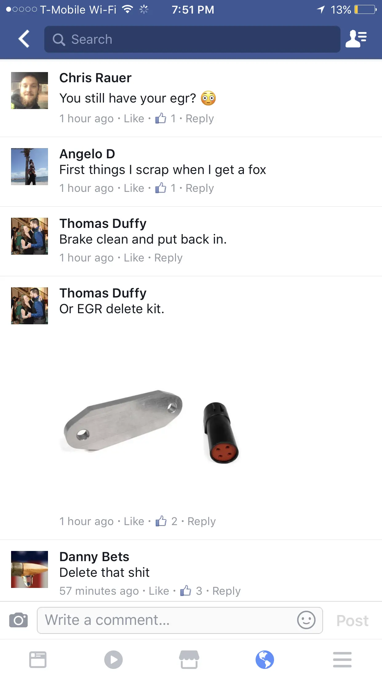

Yup. Posted on a Facebook group asking for suggestions for what to clean it with. Was reminded why I get advice here. Out of like 15 answers, only 1 suggested I fix it. The rest were to delete it.
