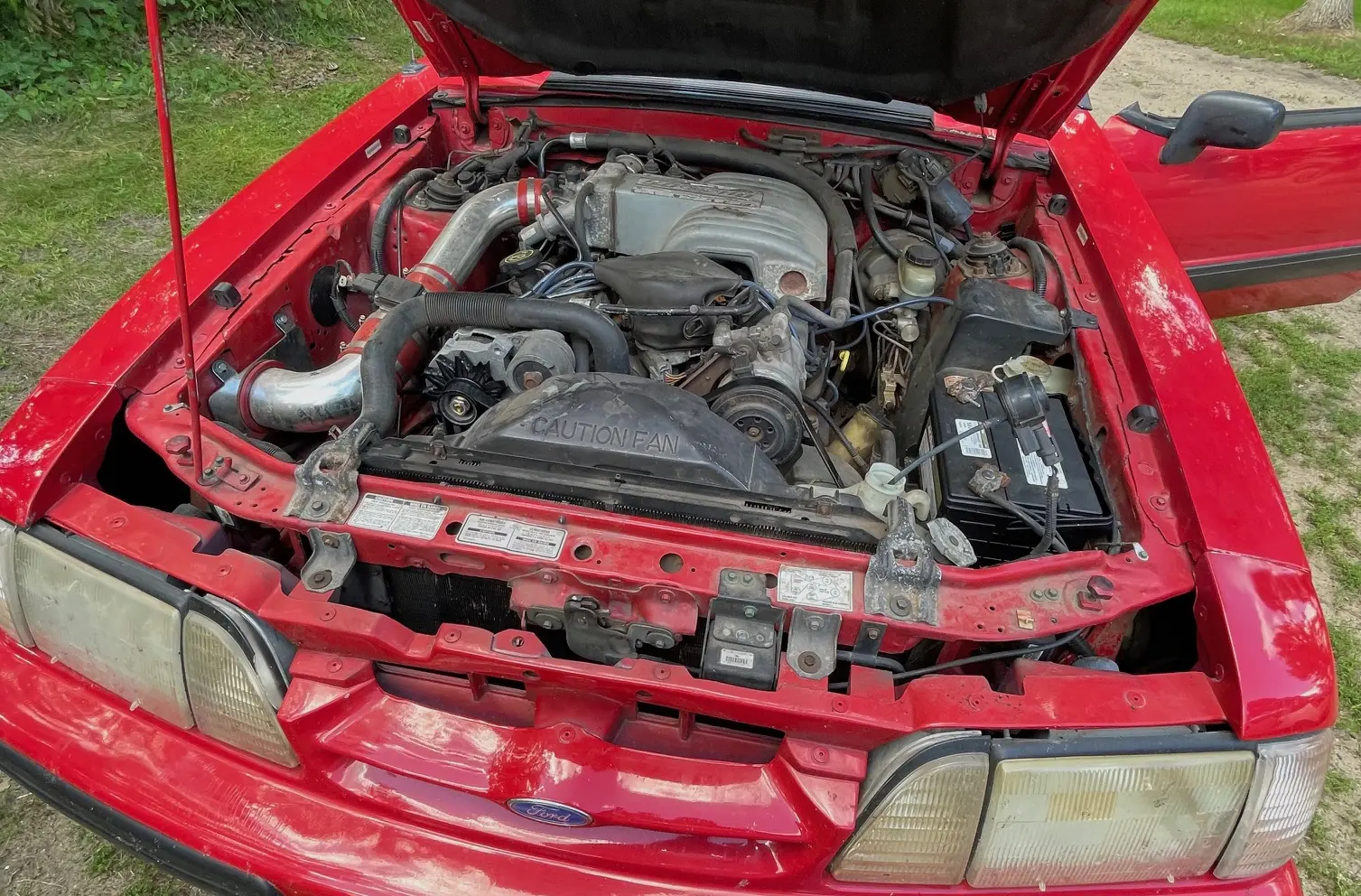

I guess I fibbed when I said "bone stock". There was/is a CAI installed so no stock box.
Thanks for the info on the MAF upgrade. There are quite a few junkyard MAFs that you referenced around me.
I basically need to decide if I want to use the 19's from the Mountaineer and do this upgrade or go big with 30's and get a MAF (like the PMAS) to match.
Where/how much do I want to spend?! Always the question :thinking:

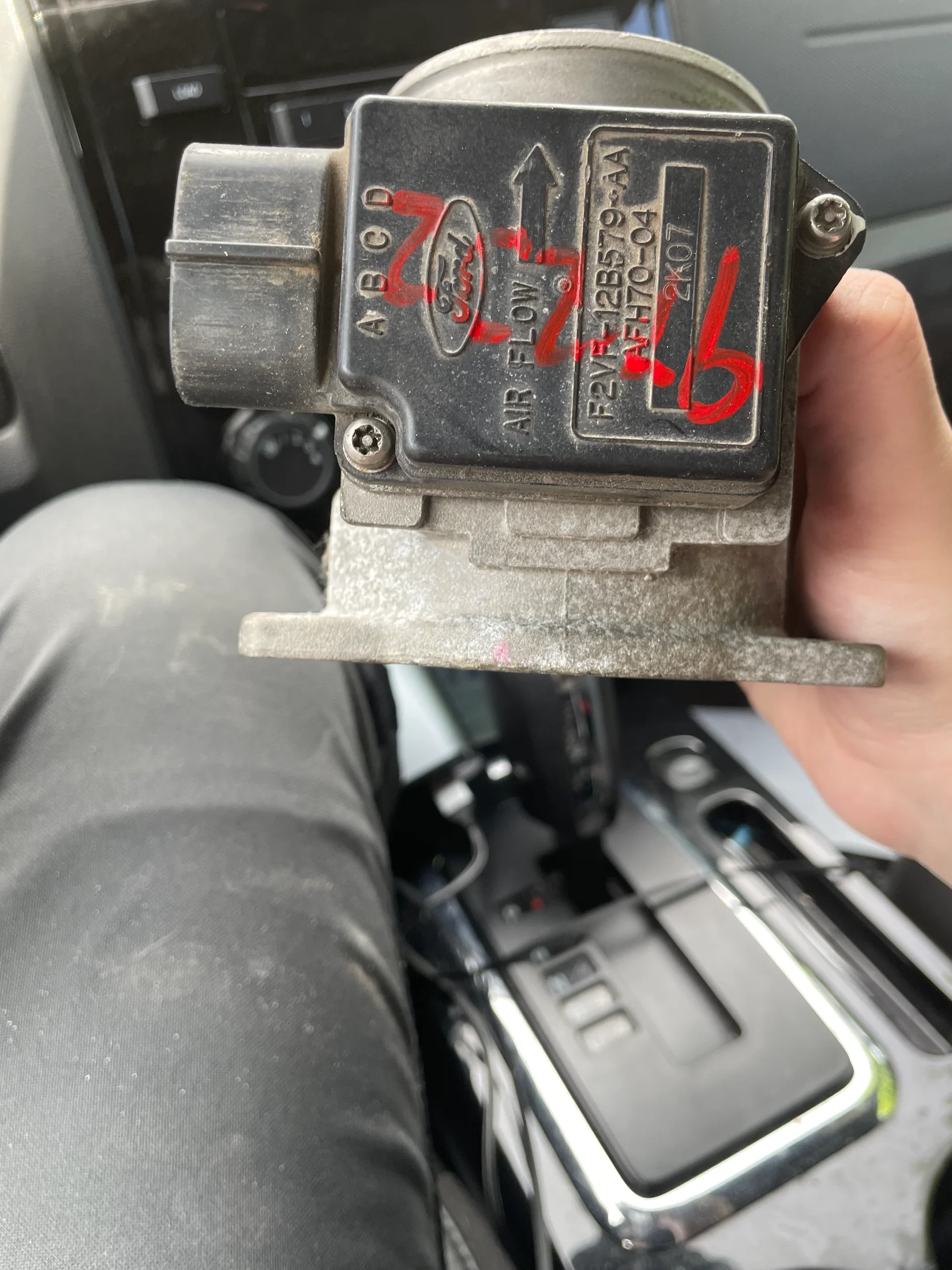

What car did you pull the MAF from in the junkyard? What are the part numbers on the MAF?
My son picked it up for me as he lives nearby the JY which is over an hour from me. I would measure it but don't have it in hand yet. It was off a '94 Towncar. Part number F2VF-12B579-AA
